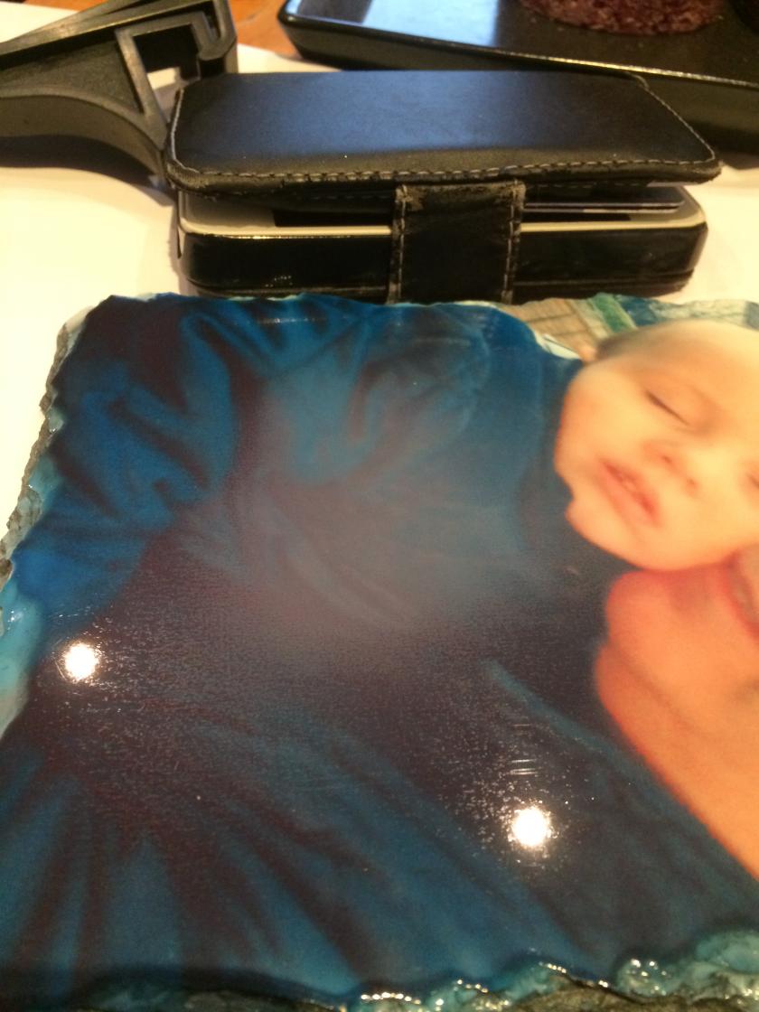

This is the issue I am having
(pic quality is poor but customer was 100% sure she wanted it even though I told her)
ANy tips on removal or what I am doing wrong
[ATTACH=CONFIG]2388[/ATTACH]

Interesting will try that, I followed Pauls tutorial and have had good results the pic above is by far the worst one I have done, paul makes a point of saying some people do face down but he was against it, I will give it a try and update on my results. Thanks

Doing pauls way the pic was a lot clearer except for the blur (see my pic above)
