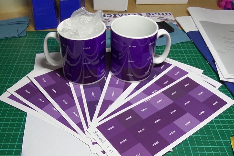

I have spent a week now trying to perfect a 'Purple' so any help would be appreciated

To be honest Nik, we never quite got round to it...that particular job wasn't that important that it matched 100% as it was for ourselves, so as it was busy I just left it and decided to get a profile done from Paul when I could. That was Christmas and of course, I still haven't gotten around to it...but it's still on the list!! :rolleyes:NikGrey;87272 wrote:I have spent a week now trying to perfect a 'Purple' so any help would be appreciated

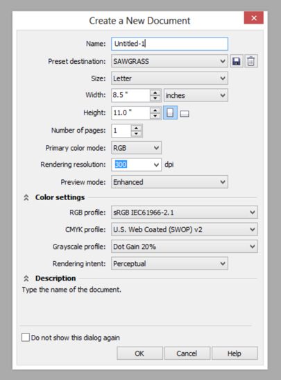

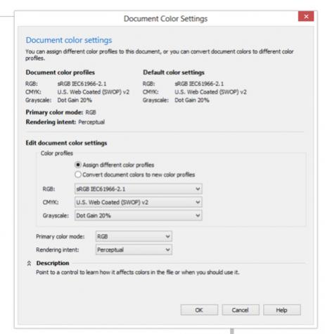

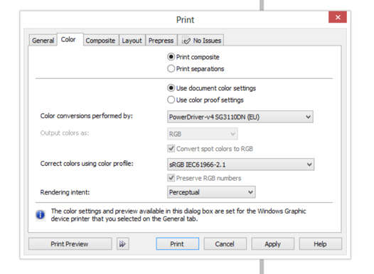

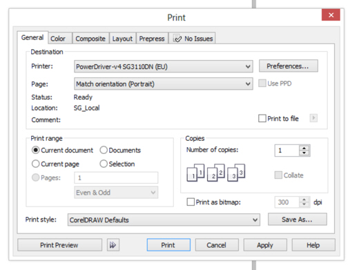

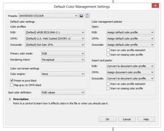

I've attached screenshots of how mine is setup according to sawgrass guides could somebody cast a second pair of eyes over these just make sure I haven't missed anything.
If I have to change to icc will this make any difference
