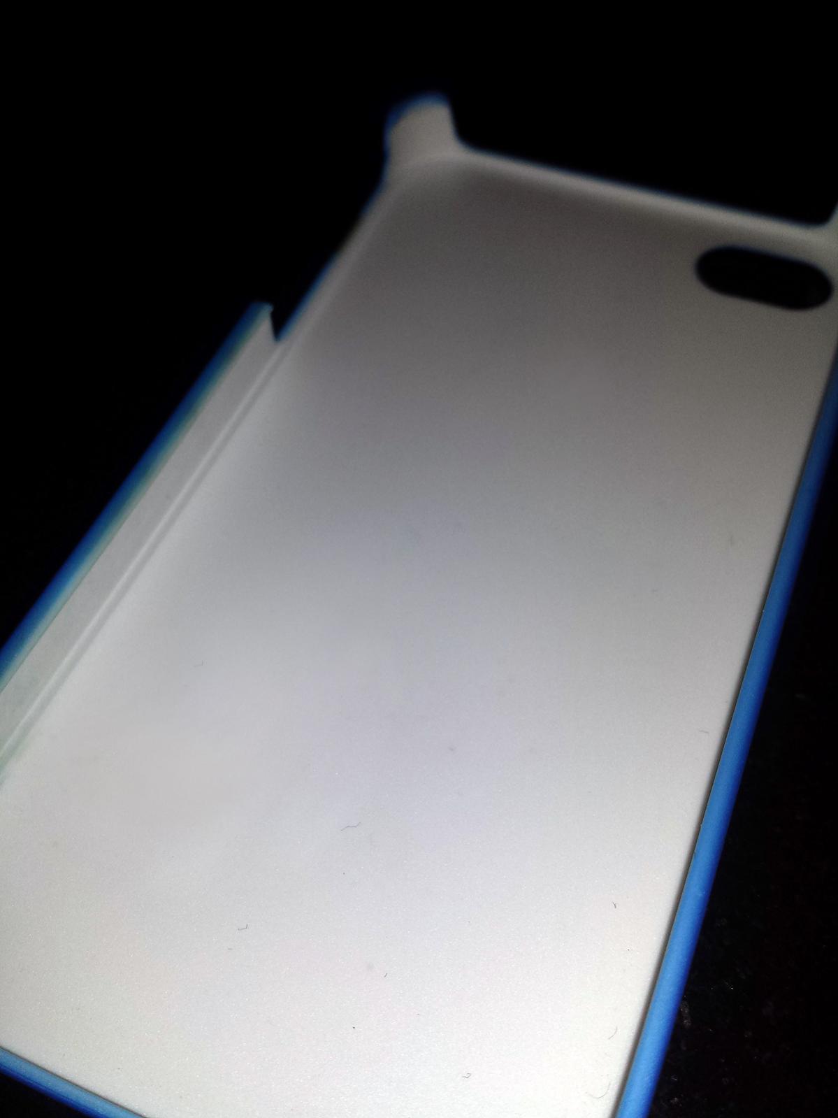

I get the mottling every now and again but, to be honest, it's my own fault. If I've had the patio doors open and the room is cold, and the prints have been sitting ready to be used then I may end up with the mottling but I put that down to them being either damp or cold as it only ever happens under those circumstances. Here's some photos of a case I've literally just finished making:

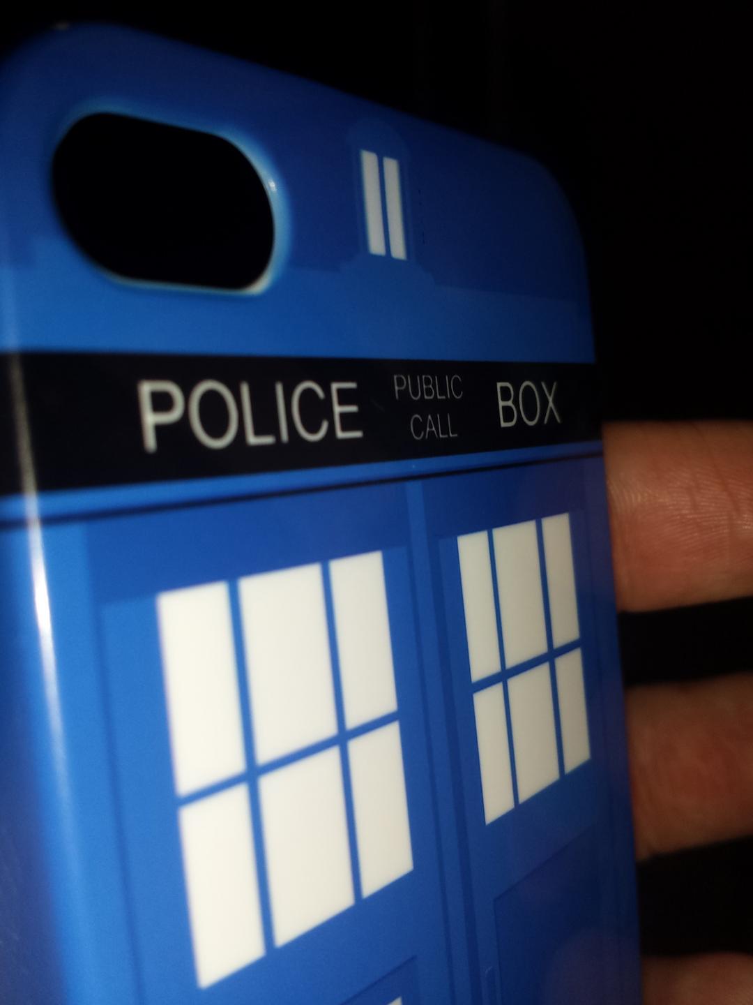

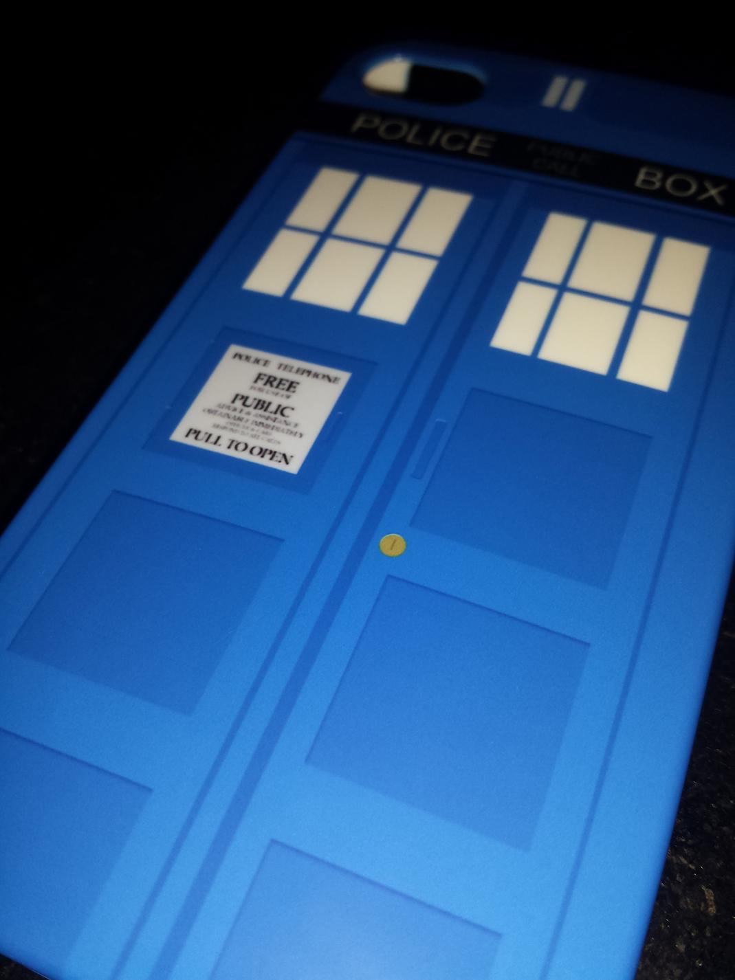

There you go... it's probably not easy to tell that this one is a clear print because of the nature of the design, but you'll see there's no breakage in the flow of the pattern or any pale spots
This one is much easier to see since it's the same TARDIS one as before and it has a solid blue, which is something that would make it really noticeable if the colours were to fade. I do admit though, if I've got a lot of orders to get through in a day, I'll not spend nearly as much time making sure each case is 100% perfect and will still send it out if there's a tiny bit of fading just as long as the case actually fits and the main area of the design is pristine. When I do each case one at a time, rather than six at a time, I never have any fading.
