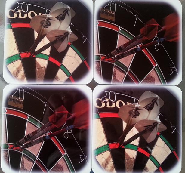

These are high gloss. I'm going to try again today & let you know what happens.
AZCanuck
Posts: 8
Joined: 02 Apr 2014, 19:14
Re: Cloudy transfer
Post by AZCanuck »
Well people, problem solved! It must have been the time, I think it was approx. double what it should have been.
This set turned out beautiful!
[ATTACH=CONFIG]2638[/ATTACH]
Thanks for all your input, it was very much appreciated!!

Frostee, if you're doing coasters, the tip on the clear plastic sheet is a dandy. I used 2 different coasters when I did mine & the first ones that screwed up didn't have the plastic on them, but the second ones did. I probably would have missed it if it hadn't been for Skye's help with the Youtube link! Just thought I would mention it FYI!
There's a wealth of info here! Thanks again for all of your support!
