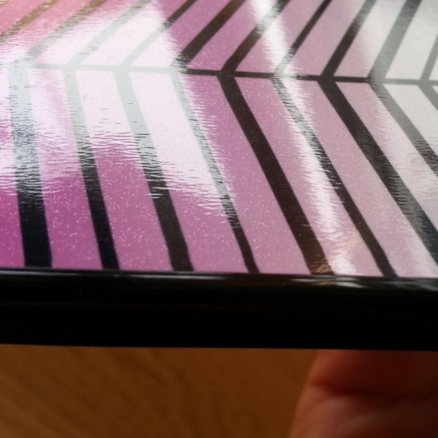

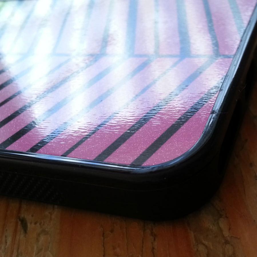

I think this specific issue with the wrinkling of the surface of the metal inserts has to do with bad quality or defective inserts. I've now purchased a few insert cases from a different company just to test and they came out perfectly smooth with a good transfer using the same time and temp I used with the inserts that had the surface issue.
I had ordered both glitter and plain white inserts from the company that sent me the "bad" inserts and found the wrinkling effect worse on the glitter ones but it happens on the plain white ones too. The odd thing is that the type of rubber case I ordered for testing from the company with the good inserts is exactly the same as the cases I got from the company with bad inserts but the inserts must be different somehow.
Here are a couple of photos showing the surface wrinkling effect of the inserts:
[ATTACH=CONFIG]2882[/ATTACH][ATTACH=CONFIG]2883[/ATTACH]
I think this is probably a different thing from the mottling effect people are talking about with the 3d sublimated cases. I've tried printing some 3d cases too (with paper) and get a very slight effect visible when light hits the surface from a certain angle, it looks a little bit like the surface is greasy but it is hardly visible so i've decided to ignore it.

Before printing the insets from the bad batch are pretty much smooth, they only have a hardly noticeable slight ripple (it's so slight that I would ignore it and use them if the surface stayed the same after printing). The ripples/wrinkles become a lot more pronounced after printing (as you can see from the photos) and it gets worse the higher the temp and longer the time. I think it's so bad that I don't want to sell any cases using these inserts. Especially now that I tried inserts that stay perfectly smooth. Shame I have 200 of the bad ones! Will try to contact the company I bought them from and ask if they are aware of the issue but might be problematic as they are in China. Fortunately the UK company I got the good inserts from had exactly the same model of case so I can order spare inserts from them and still use the cases I got from China.ArferMo;90437 wrote:Are they ripply like that before printing or only after.
