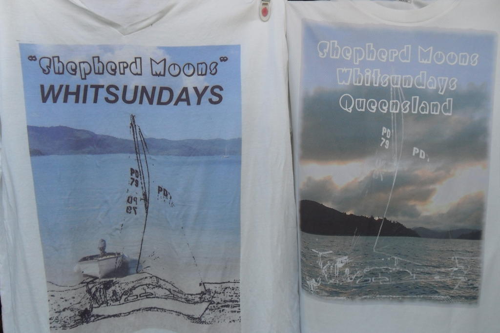

Here is due subbed cotton (on left - bright blue) after 7 hot soaks and hot washes and dye subbed polyester (on right - sunrise, dark clouds) number of washes is irrelevant side by side.
And responding to the 'why would you bother?' thing. I bother because I prefer working with dye sub. I bother because some day soon it will be a normal every day product. I bother because in the tropics people still have this thing about cotton being nicer to wear, even though you and I know the advantages of polyester. I bother because it can be done.

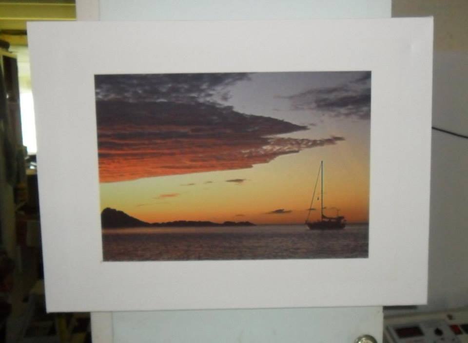

One from this afternoon. The original is from a photograph of the pic in the middle of a poster made in the 1970's, scanned and enlarged to A3. Some people think I do mostly sunsets because subbing into cotton won;t do bright colours.

For Tony, here's that pre-stretched cotton canvas. Blank framed canvas costs $8 stretched, sells for $35, after printing.[ATTACH=CONFIG]2324[/ATTACH]

Your framed canvas doesn't look quite as 'dynamic' or have the impact I would expect from such a colour saturated sunset. Is it like that in the finished article or is it due to the photograph? I only ask because I print my canvases on a Versacamm with eco solvent inks and having done similar sunsets the colours on those really 'pop'.rossdv8;81531 wrote:Thanks. I am not trying to revolutionise this industry overnight. I try to open people's eyes to other opportunities, and get some interest going. It is a very small step from what I, and some others are achieving now, to a commercially viable product. And while the bulk of people on the forum are only in it for the money, some of us do the normal basic stuff as a 'job' and the fun stuff like this as a 'hobby'.

Have you a similar pic that you can post so we can see what you mean please Roger?RogerC;81533 wrote:Your framed canvas doesn't look quite as 'dynamic' or have the impact I would expect from such a colour saturated sunset. Is it like that in the finished article or is it due to the photograph? I only ask because I print my canvases on a Versacamm with eco solvent inks and having done similar sunsets the colours on those really 'pop'.

Hi Roger,
I have the dye sub printer pretty closely matched to the pigment printer, and previously I posted the original pic side by side with the finished result in another thread. It does match the pigment output closely and also the original.
If I printed it on polyester canvas it would get a bit of artificial 'pop'.
What I'm doing, as with the cotton shirts, is playing with a market that is there, but not exploited.
Think about it. Previously I was printing direct to canvas with pigment.
Consider the time involved to:
print the canvas
trim the canvas
prepare the frame
stretch the canvas
I base everything on an hourly rate, and it is time consuming.
Now for the pre-stretched canvas.
Print the image on sub paper and while it is printing, spray coat the canvas which is bought stretched, framed. (maybe 30 seconds - reality is about 15sec.)
Drop the frame over the platen of the press.
press for 40 to 60 seconds depending if you want a dark, stormy image or a light vibrant one.
We have taken the finished canvas outside and sprayed it with a garden hose and discovered it is colour fast. This is necessary as some of our stuff is transported by open dinghy.
