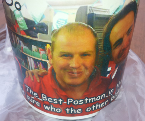

I have the profile and made a test Mug, Im not too worried about that acutal image here as I found the image via facebook - this is a surprise for my Postman so serves as a good test subject. I am more worried here about the 'Black' stroke around the lettering which looks more dark blue.
Any idea's?
Any idea's?

I have the profile and made a test Mug, Im not too worried about that acual image here as I found the image via facebook - this is a surprise for my Postman so serves as a good test subject. I am more worried here about the 'Black' stroke around the lettering which looks more dark blue.
Any idea's?
Any idea's?

Is the outline actually specified as black in photoshop?
Open the file and check that it is 100K and not a mish mash of CMY to make it look like black.
Re: First ever Mug - Bad, Need help !
Either there is something wrong with the way you're using the profile, or the original photo has very yellow flesh tones/lighting? (or it could be this new monitor which I haven't calibrated yet!)

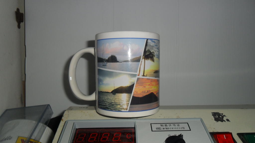

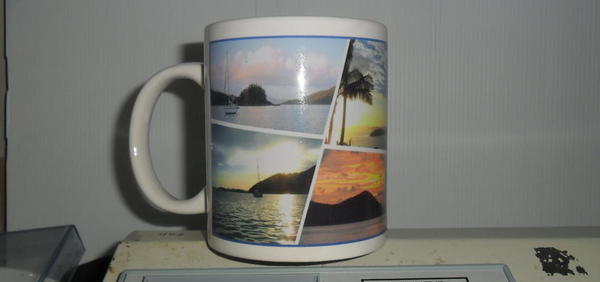

Might be an idea to post a copy of the original image (not on a mug) and the image as it appears on the mug so people like pisquee and paul can give their opinion based on how the image and mug appear side by side.
This is what I mean.
One pic is the output from my auto-script ready to print, one is the other output from my auto-script so I see what it 'might' look like on a mug, and the other is a photo of the mug after printing that output.
Comparing them side by side you can see that because I am not able to use ICC profiles and I use the wrong brand of printer, the colours on the mug don;t match the colours on the original and the example, particularly the blue in the sky..
But they are close enough for my purposes, because I only work with my own photos.[ATTACH=CONFIG]1969[/ATTACH][ATTACH=CONFIG]1970[/ATTACH][ATTACH=CONFIG]1972[/ATTACH]

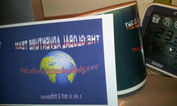

ok, I am back on the Mug again. I have a profile from Paul and used the correct paper for this job.
I realise I need more pressure at the top of the mug but things like that dont bother me as I know I can easily overcome them, what worries me is the Black going more of a dark Green. I am using the 'Cold Press' method: Place Mug in press, turn on (press gets to 200) then hit Set to make it increase to 360 - then counts down 30 secs and remove Mug.
My mate insists on using this log although I have offered to create a proper one, and it is a .jpg - I made sure the Black was 000000 (Where is the hash on a Mac keyboard).
The paper below was not the paper I used as I printed test prints on the pre-cut stuff I bought for sizing etc but it looks identical (apart from small white flecks in the Black, those flecks didnt appear in the xPress paper I used to have the ICC profile set up with).
When I have better light I will post a better image here but for now what do you make of this:
[ATTACH=CONFIG]1999[/ATTACH]
Oh, And the mugs have an Orca coating.
