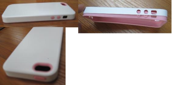

Yep for sure. The machine i ordered is coming with samples as well. On top of that the phone cases which i am having custom made are according to my drawings and materials. This means that the finished product is of good quality. However because i choose to use the best materials and stuff it cost me about 1.2 USD per phone case. Here is some pics of an iphone 5 case which has a sublimation shell and inner silicon bumper.

Re: 3D sublmation Machine Review
Hi, i am new to this industry and have recently purchased this machine. I have been testing it on iphone cases for about a week and so far i am pleased with the results using paper. I am however having difficulty in using the gold backed film which i was hoping would produce better results but so far i cannot achieve a good result. I have tried various times and temps but to no avail. If you experiment with your machine using film please let me know how you get on.
