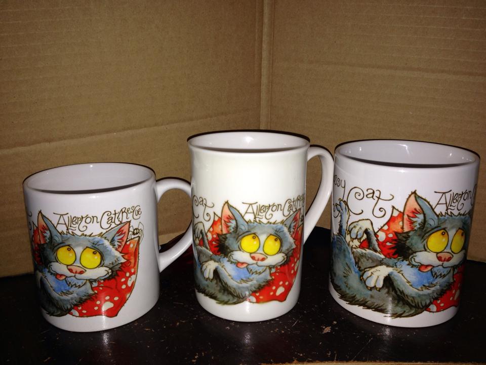

I have both samples from listawood in china mugs,they are fantastic and can both take a full wrap on each mug.[ATTACH=CONFIG]2401[/ATTACH]
first 2 mugs left to right are the china mugs,quality is good,colour is good,and dishwasher proof.I did buy some from ebay as a trial with a fluted top and have a gold rim,these are very stupid mugs, you have to skew the artwork to get them to look good,and you can't do a full wrap even using a different blanket in your press due to the lip.The two mugs from listawood ,and they do another one slightly taller are the best I have found
hope this helps
hope this helps

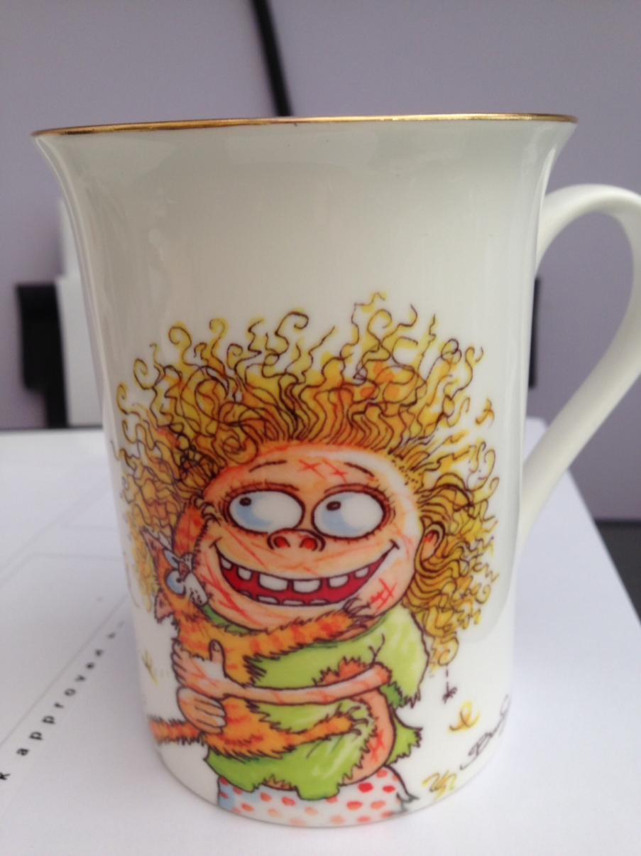

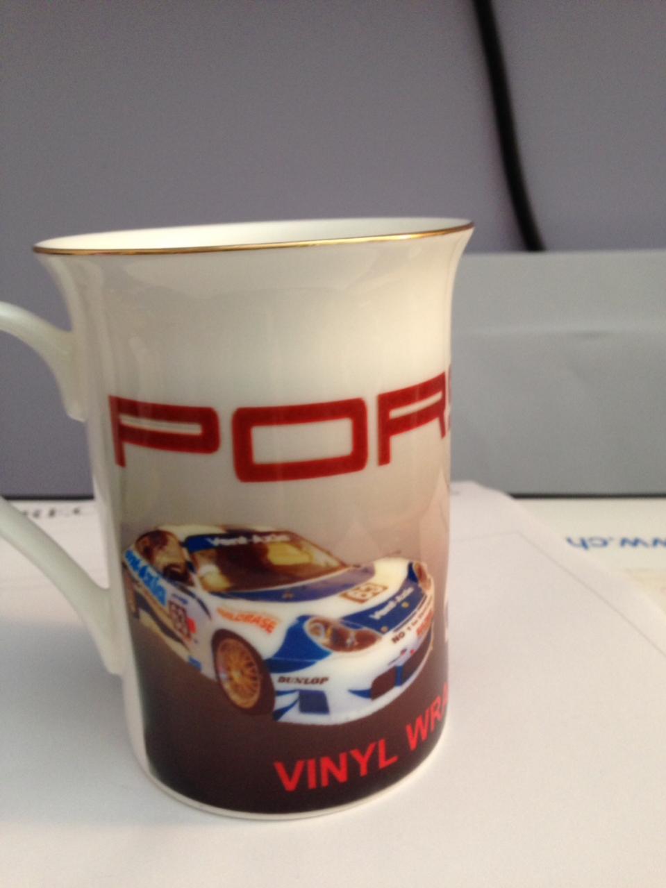

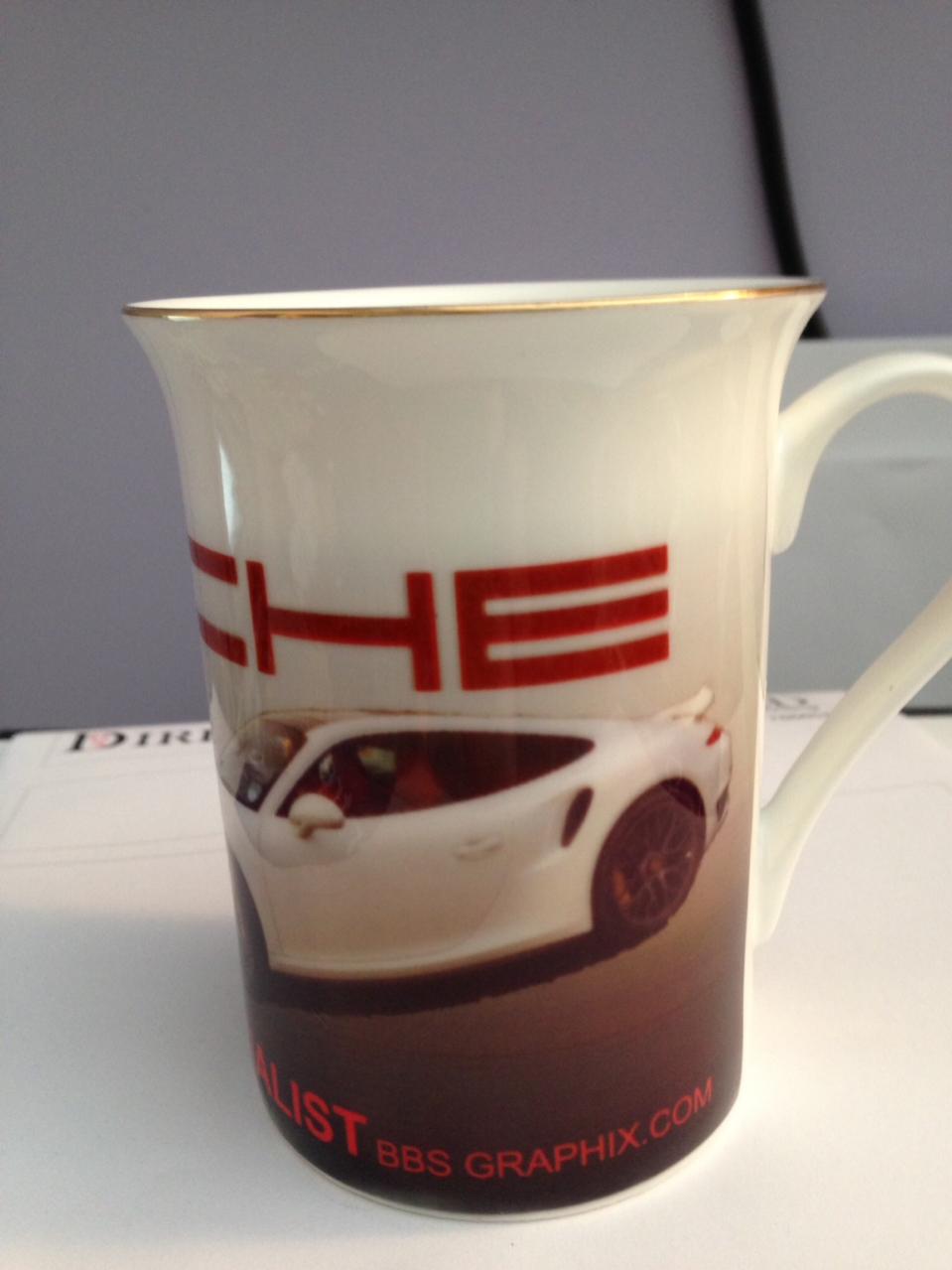

A few examples using the gold fluted china mug,looks ok but anything with a background looks rubbish
[ATTACH=CONFIG]2402[/ATTACH][ATTACH=CONFIG]2403[/ATTACH][ATTACH=CONFIG]2404[/ATTACH]
