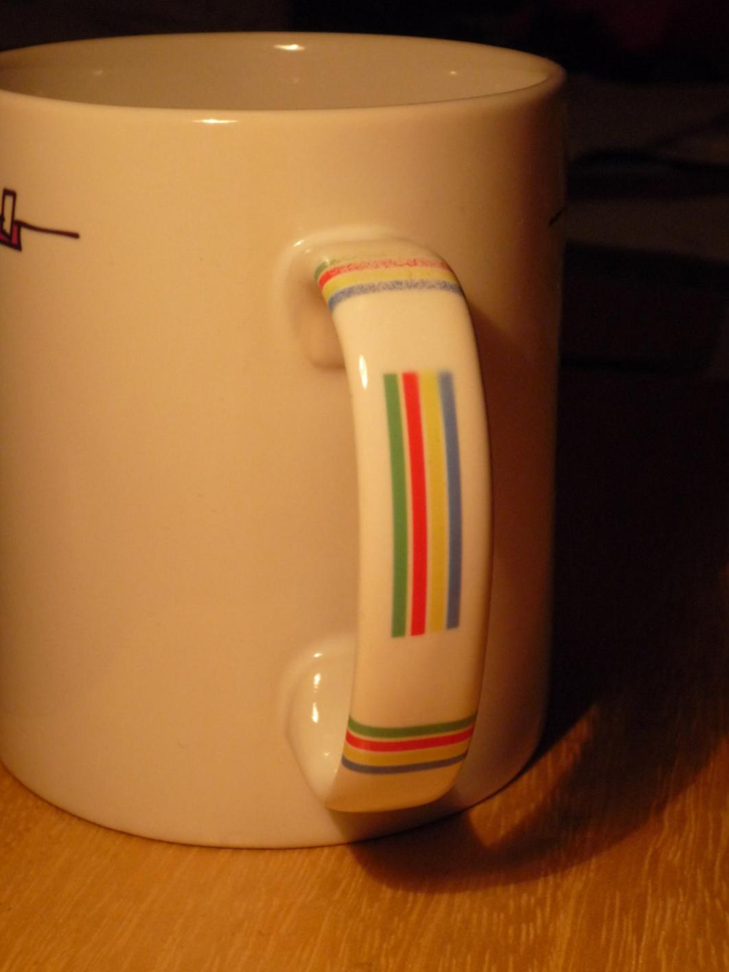

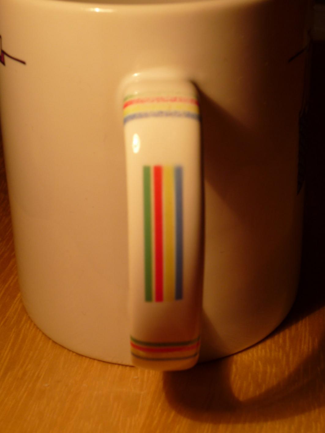

Right, had the oven on today, and a faulty mug spare so I thought I'd try printing on the handle. (Mugs BMS RN coated, trupix, Ricoh + SublijetR, 17 minutes 200C (in a clamp anyway to keep consistency with rest of run).
So you can, but it is a bit of a faff. I taped it as best I could, but you can see from these (rather poor) pics that good contact is (obviously) essential. Might be feasible for putting a web address on the outside of the handle (if total perfection is not essential), though the print does go right round the handle (though not very well) on the top and bottom horizontal sets of stripes.
[ATTACH=CONFIG]1308[/ATTACH][ATTACH=CONFIG]1309[/ATTACH]
So in brief, yes it is possible to print the handle in an oven.
Neil.
Oh, forgot to add the mug I printed on was previously printed, and very little ink came off onto the protective paper I wrapped it in, so in answer to a question a long time ago, it would be possible to pre-print a run and then add names etc (presuming it will print OK second time round - no reason I can see why not) or to add things that were omitted.

Thanks for the info and this is really very interesting to me and I can see many uses for it. If for example you limit the print area to get consistently good results I still think it has nice potential as an add on service that could be charged quite high in my opinion.

Yes, I think if you were to limit it to the 'flattest' part of the handle then it would be feasible. I tried the top and bottom stripes mainly to see if the coating went right round!
