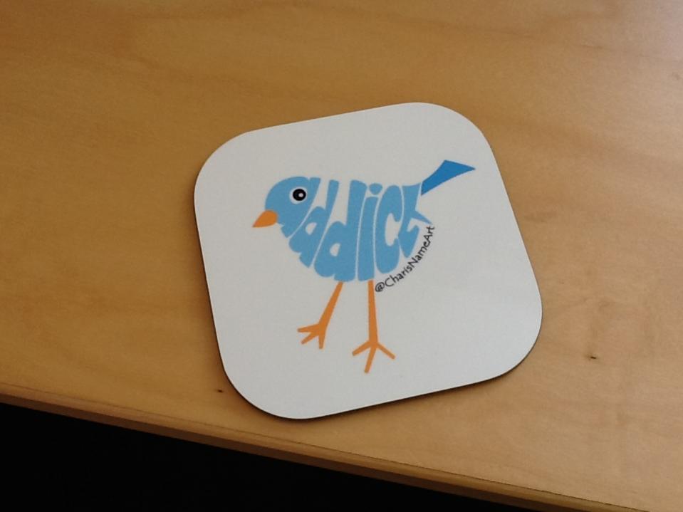

MASSIVE thank you to Brett, just needed a calm voice on the other end of the phone. Have successfully printed my first coaster...nothing blew up, nothing melted...quite smelly...but then, so is my mug press.
[ATTACH=CONFIG]1184[/ATTACH]

Well done Charis & that coaster looks superb.
