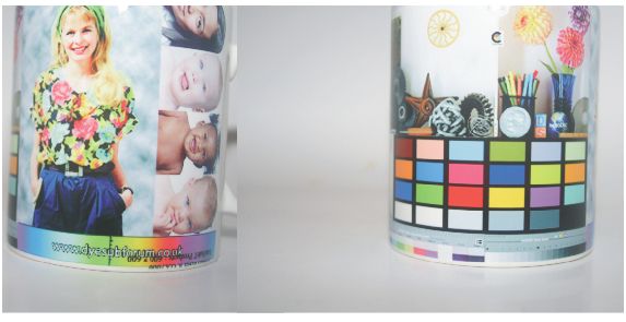

On the image you posted up there for me, on the large colour panel, the 4th from the left, 2nd from the top, the colour looks like maroon/purple.
Can you tell me what colour that is please as when I pressed it, it came out the colour I need :O
Will go find my camera and take a piccy and show you what I mean.
I'm on my mac just now, using coreldraw X4, with the powerdriver set as sawgrass recommend, and it still came out royal blue, lol

Post by Kaz »
Hope this works, photography isn't my strong point, lol
