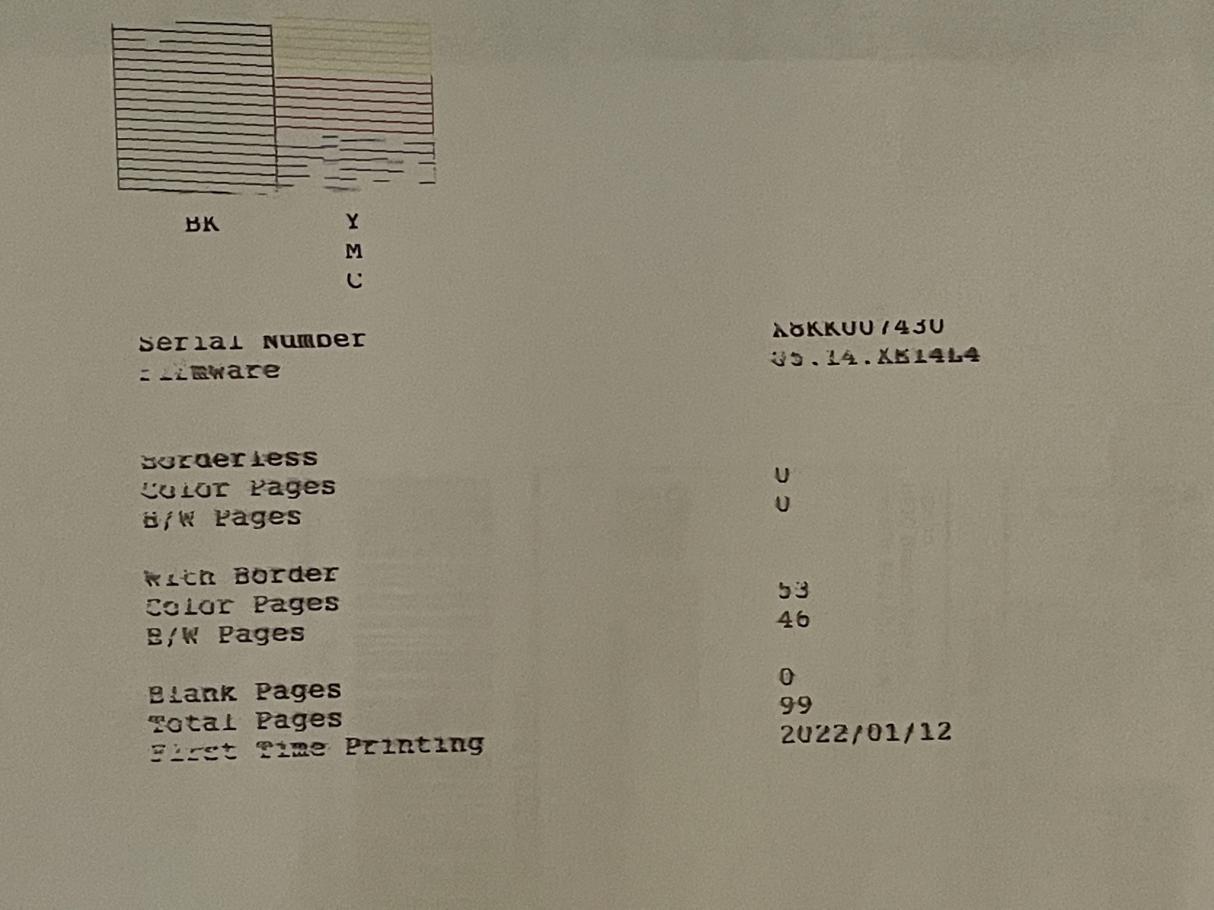

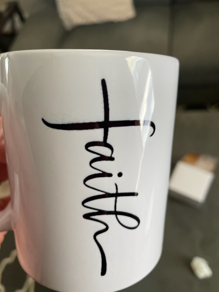

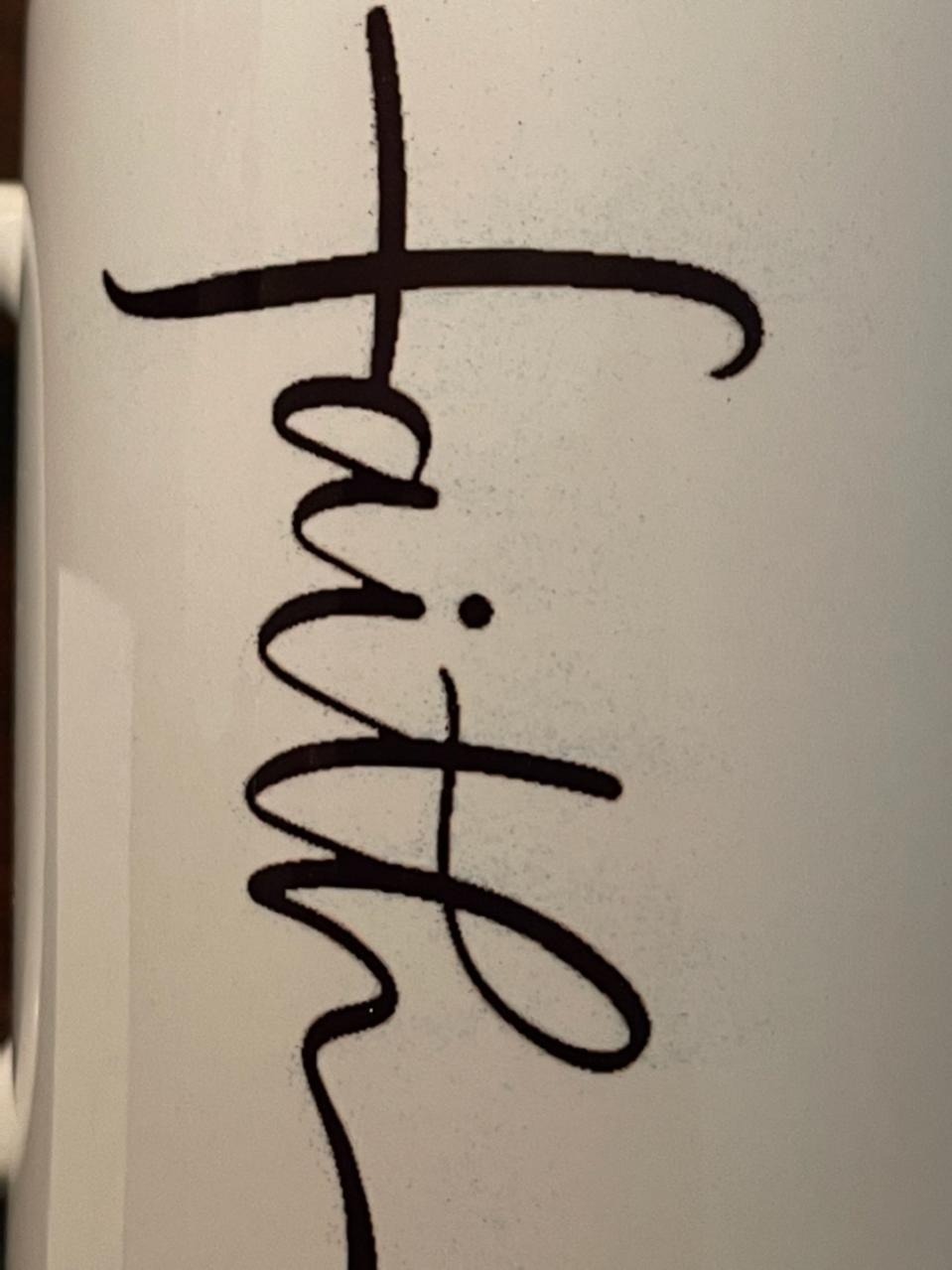

Thank you all again for your input. I've attached a few pictures. As you can see, the nozzle test doesn't look too good. I thought this was just because of using sublimation ink instead of normal toner, but apparently not. Is there anything I can do about this manually? I've already run the print head cleaning and the power cleaning and it doesn't seem to help. I experimented with a couple of mugs and the problem is persisting. I've attached a few pictures.
The first image shows the overspray (I'm guessing that's the problem at this point), even though this was printed at highest quality (presentation matte paper setting) just after a cleaning.
The second image is a mug I cooled in water right after it came out of the press. The overspray is more blue-ish, but still obviously very visible.
The third image is of the nozzle check.
What can I do about the overspray if the nozzle cleaning doesn't seem to be helping? I don't think I can complain to Epson because if I remember correctly their warranty is voided if you use sublimation ink? Is there anything I can do, hopefully other than purchasing a new printer?

Problem Solved. Thank you all again for the input. I will post the link to the video that solved the problem. In the video he advertises a solution, but I just used hot water. The problem was overspray, however running the cleanings wasn't helping. I had to open the printer and manually clean the print heads. Thanks again.
