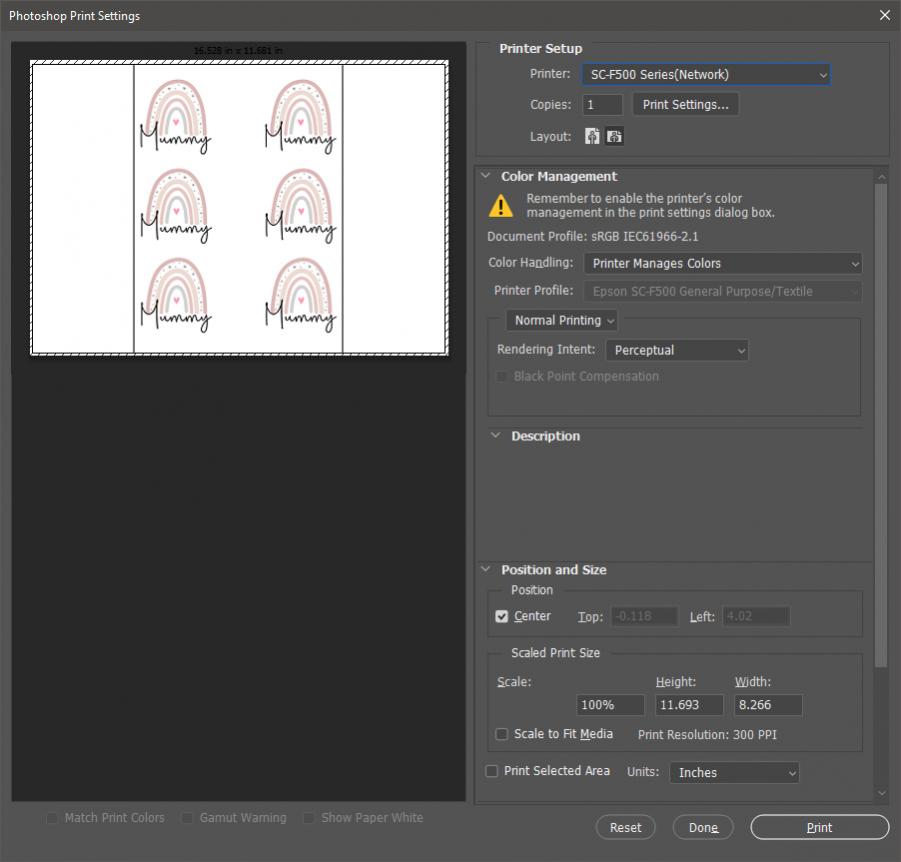

I let printer manage colour in photoshop. Matching the exact colour is not critical to me so this works well.[ATTACH=CONFIG]6597[/ATTACH]mrc1312;147671 wrote:Thanks for doing that, doesn't look that much different to mine really I don't think.
Do you not set the ICC profile within Photoshop? I think if you leave it on simple settings and standard there is ICM colour profile matching still enabled within the driver.
