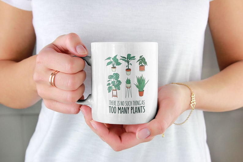

An example is this design.
I am currently putting it in for 180 with the base facing outwards, then I have to put it in again with half the mug in with the base facing inwards else the text at the bottom really fades.
Would it be normal to expect to be able to press that in 180 seconds?
[ATTACH=CONFIG]6461[/ATTACH]

Re: Freesub ST210 recommended settings?
Yes, there is no reason to do anything apart from put in press and press the timer which is set to 167 temp for 170 seconds - comes out perfect every time. Mugs and paper from Xpres, inks are genuine Sawgrass through a Ricoh. Sounds like your press/blanket is knackered, or set to Fahrenheit instead of Celsius.
It did go to F randomly the other day but I am pretty sure it's in C as it's hotter than 180F, it has been like it since I bought it brand new so I have been pressing them twice to do top and bottom.

I posted a full mug print image somewhere? I did it in my mdp press 180oc for 180 seconds from room temp and it’s fine
I never turn or put a mug in a press more than once.
if it’s not doing it first time then your settings are wrong somewhere.
