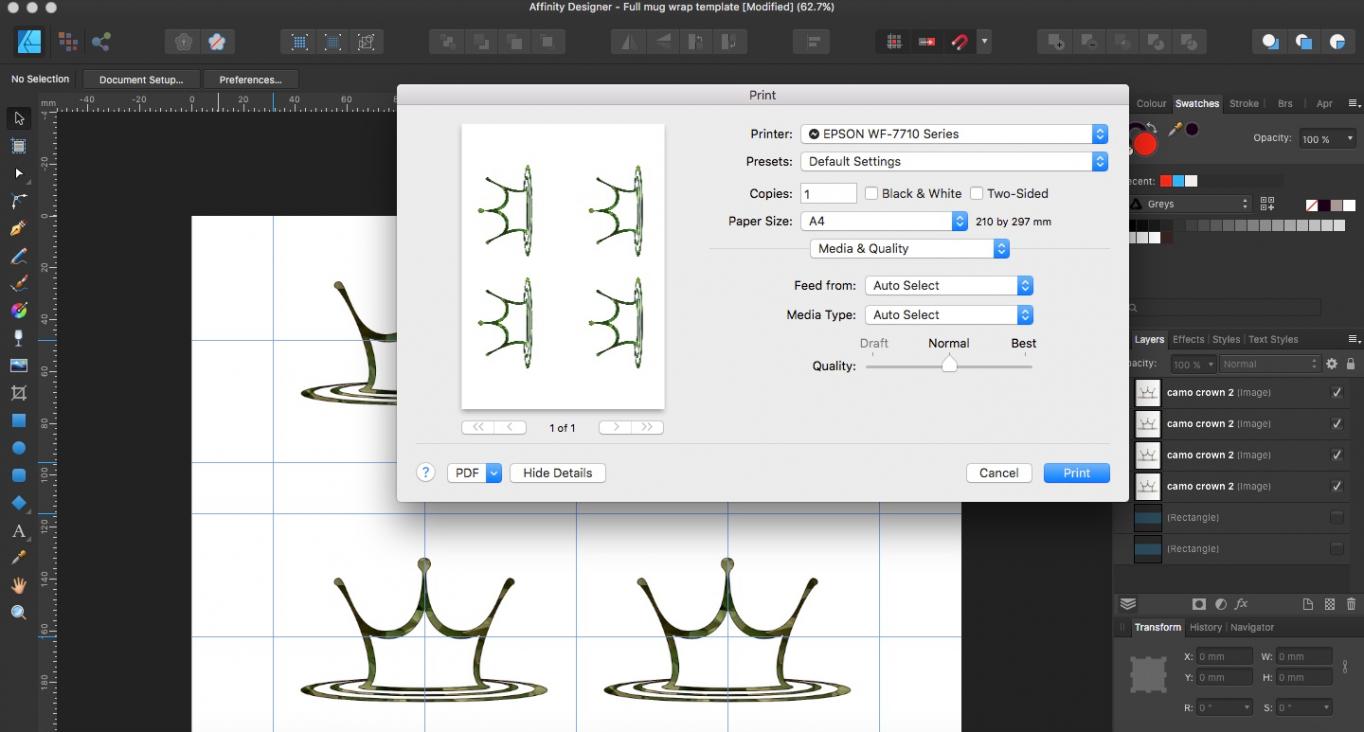

Thanks for the help, Im not seeing where the colour tab is :) on my PS it there as a drop down menu, but cant seem to find it on Affinity.

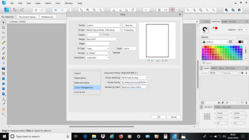

File>Print>colour management. Then set your colour handling to 'performed by app' and your printer profile to whatever your sub profile is.

Here is a screen shot - I have set by User interface to light background, but everyhing else is the same.

Sadly Im not getting the colour management box pop up :( cant find it anywhere, are you using a pc by chance? Im on a Mac and not getting the same menu as you are.

I can confirm that my version of Affinity Designer on Win7 produces the same Print dialogue box as that shown by PW66 above. I can choose my ICC profiles from the dropdown list.

webtrekker;139061 wrote:I can confirm that my version of Affinity Designer on Win7 produces the same Print dialogue box as that shown by PW66 above. I can choose my ICC profiles from the dropdown list.
Ok cool, must be a Mac thing then :)
