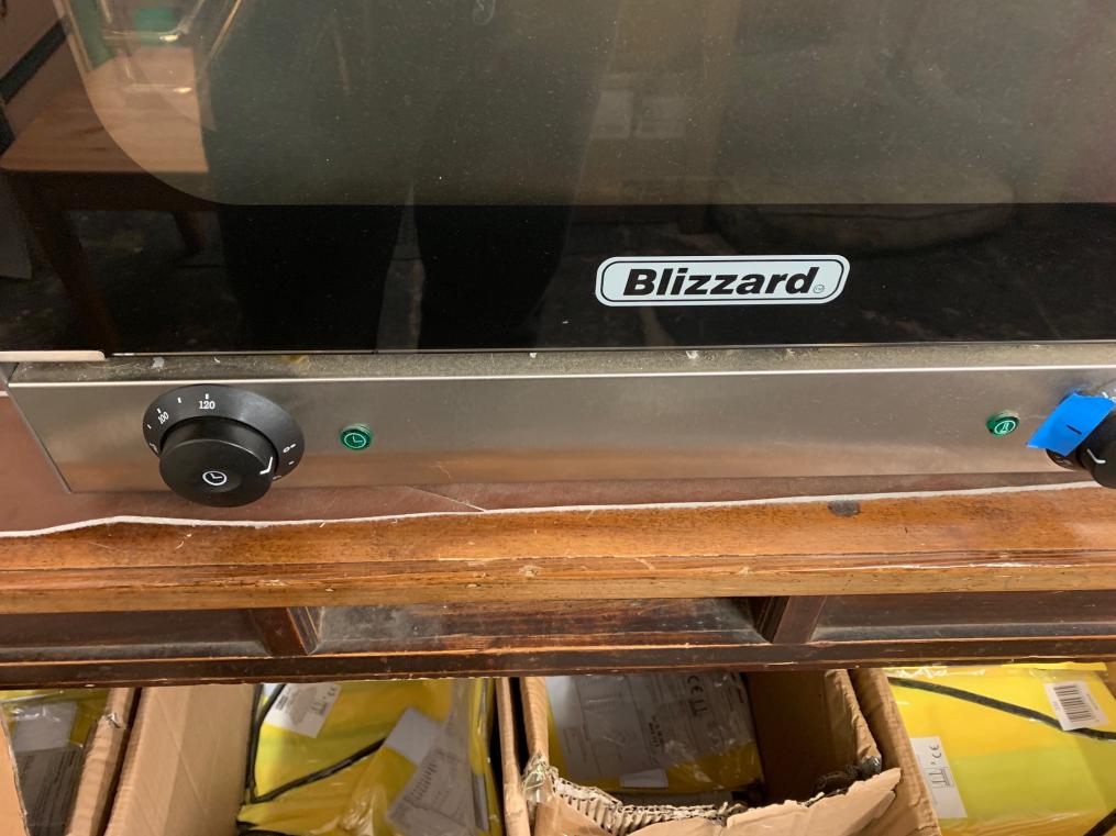

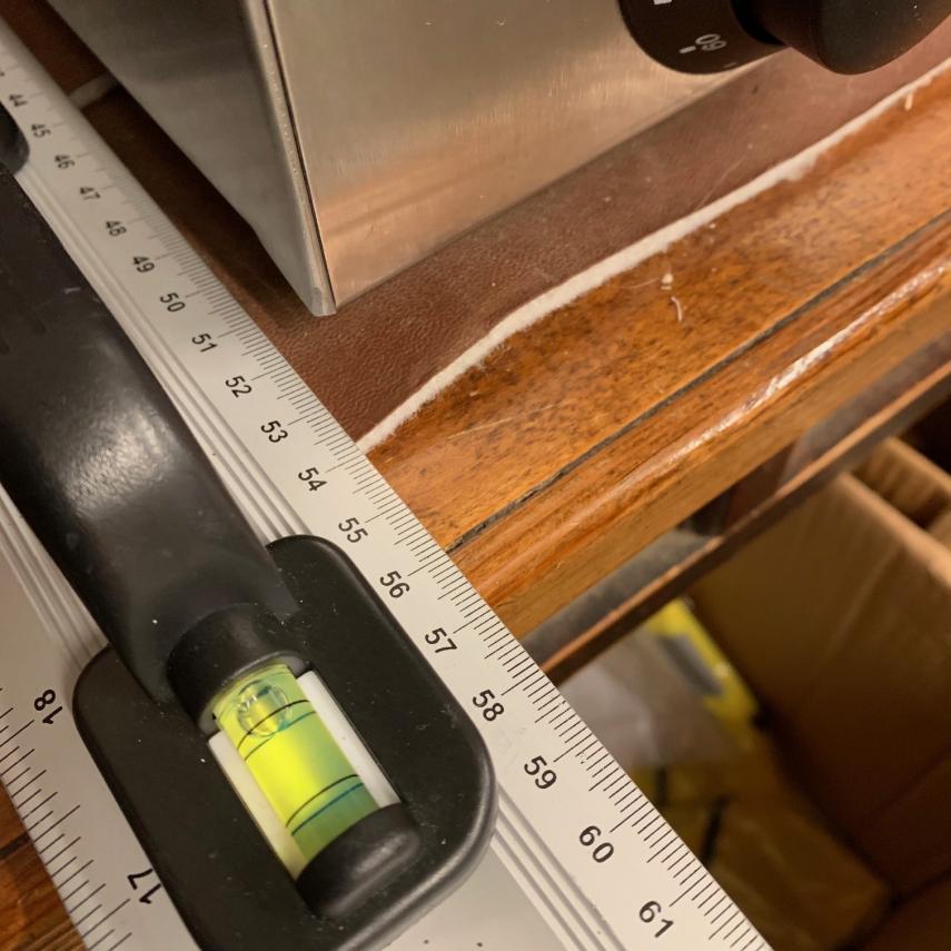

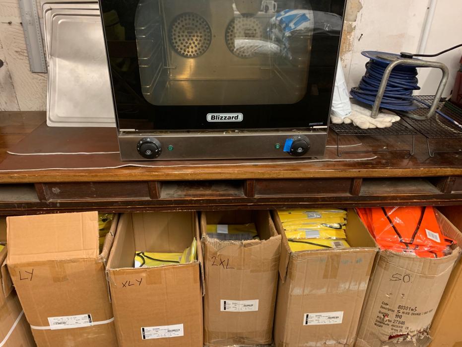

Gooner, take a look at how and where mine is situated. This bench is what is known as a nuns dining table (obviously from my past life:eek:), it is solid wood with a varnished surface. I placed a bit of table cloth liner on top then plonked the oven down, there are no marks/scratches/melted bits that relate to the oven being on. It does not get that hot on the outside. Further more, you can see the depth of the table is quite narrow and you could actually overhang if you wanted to. If you want to see a different angle to the oven or table let me know.Aye, that's the one I've got bookmarked. I have this awkward cable enclosure running around my walls which reduces the depth of my worktop, preventing a 600mm oven on it...aaaahh nothing is ever straightforward. I'm assuming that you couldn't put a hot oven on an ordinary IKEA laminated table...it would probably melt?
Trust me guys, as I said to Jason and Justin, buy an oven and you will never look back. Both will confirm that it is one of their best investments...
My only gripe is that I need to either find or get some bespoke trays made. The ones that are supplied are really flimsy and after tens of thousands of mugs they really are at their end of life.

Also, Gooner I thought it was you who put me on to this particular oven. The key thing to look at is internal dimensions. I did a lot of working out on paper before going with this particular model as I wanted to be able to get sufficient amount of mugs in.Aye, that's the one I've got bookmarked.
With this model I am pretty sure that if I got some side bars made you may even be able to get 36 mugs printing in one go.

You did indeed thanks, it was the depth issue which made me look for other possibilities. But your measurements look about 8cm shorter than the advertised dimensions. Look, sod the halogen oven experiment, I'm going to order this Blizzard instead and will have a hunt for other baking trays for you.socialgiraffe;136274 wrote:Also, Gooner I thought it was you who put me on to this particular oven.

You can see where I have my dial on the images posted. It might be worth Justin and Jason posting their settings so we can compare...
Listawood 10oz @ 8 minutes
Listawood 11oz @ 9 minutes
The more mugs the longer the time, 24 mugs take 16-18 minutes for me (depending on how cold the mugs are before they go in). Don’t forget to let the oven warm up for about 15 minutes before starting your first mug.
Make sure the bleed is a max of 2mm top and bottom. I personally have no bleed at the top and 1mm at the bottom. Too much bleed and you will get the ink dispersing over the exposed areas of the mug (i.e under the handle).
Always make sure the mug paper is longer than the wrap. Mine is cut to 240mm wide although I should probably do it a few mm shorter.
