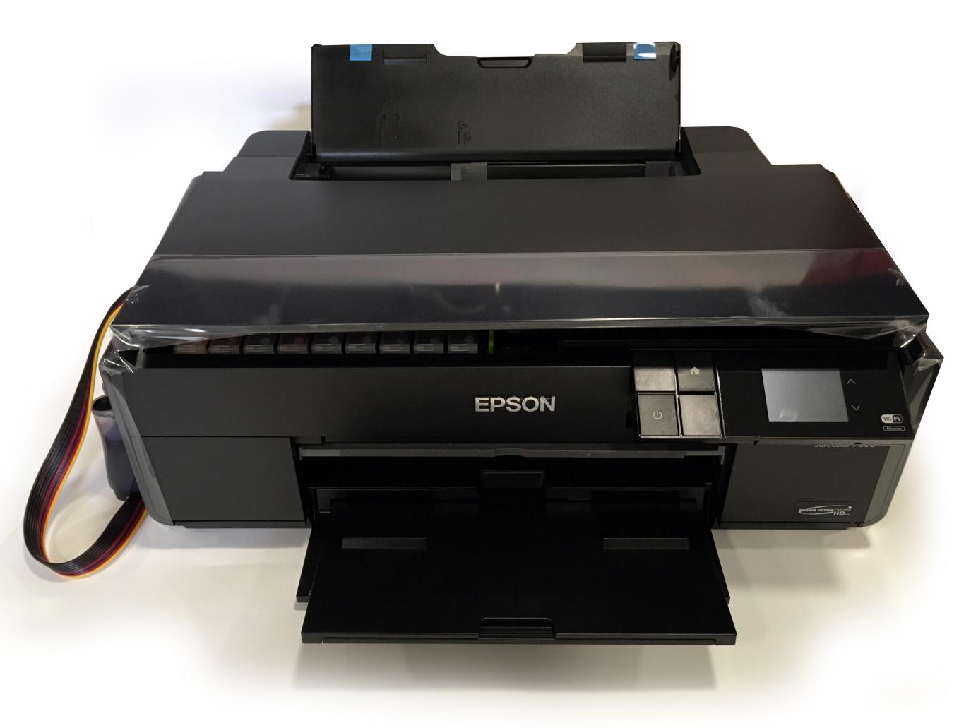

Progress with Epson Surecolor SC-P600-
Started working on the Surecolor SC-P600, for now this will be our main focus A3 printer until things start to develop with the XP-15000. We ordered a brand new SC-P600 which arrived late Friday afternoon so didn't have a chance to get started until today. First thing we noted with the new SC-P600 compared to our previous one (purchased a few years ago) was that Epson must have made a hardware change to the printer as were unable to modify it to run on a chipless firmware.
This is not the end of the world, and the printer works perfectly well on the standard chipped cartridge ink system setup we have sold for a number of years an it works very well.

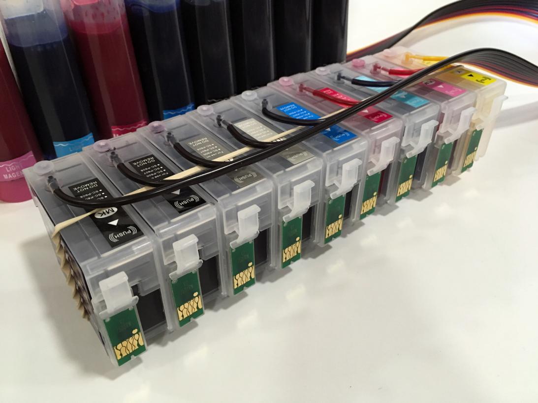

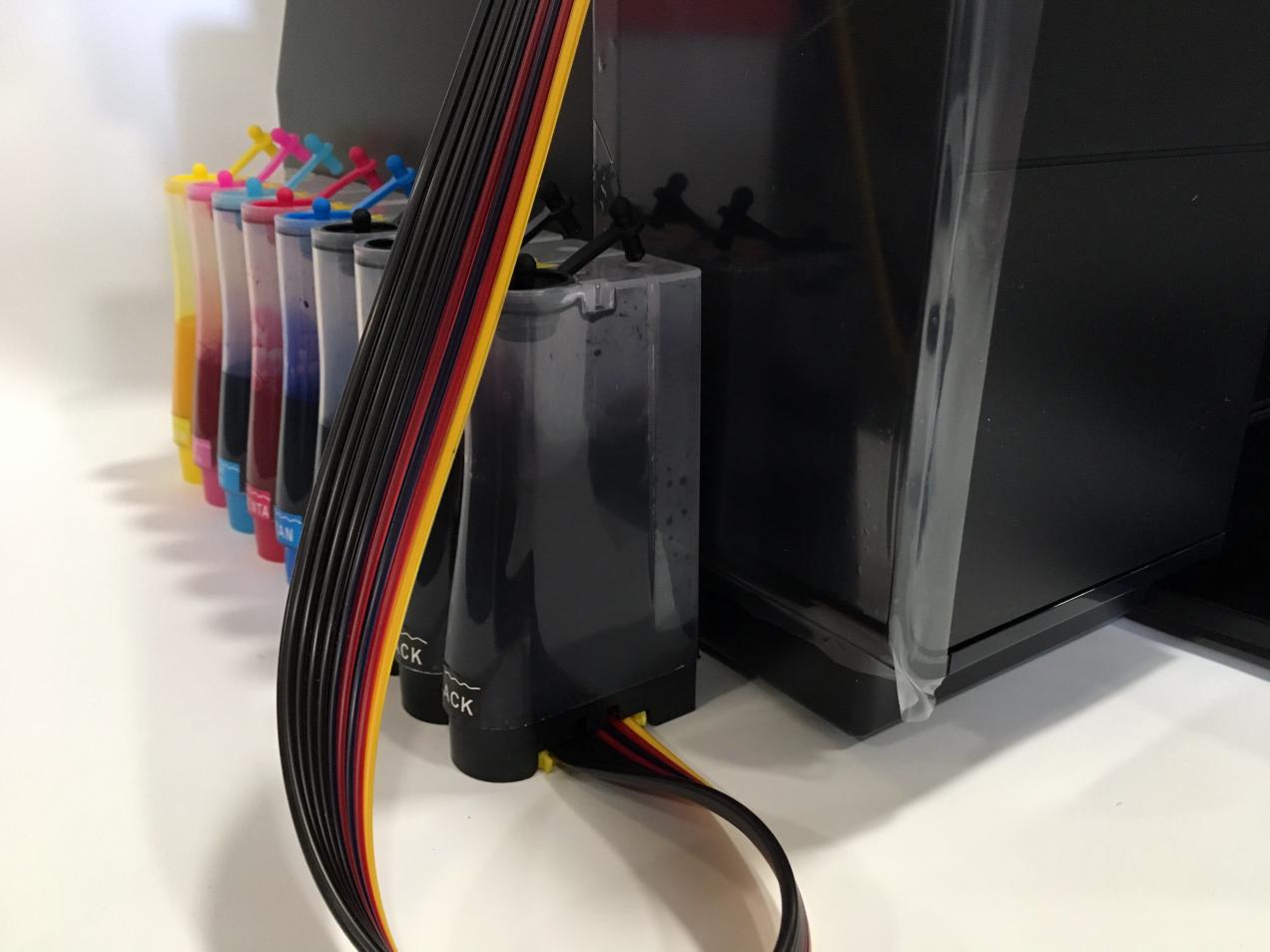

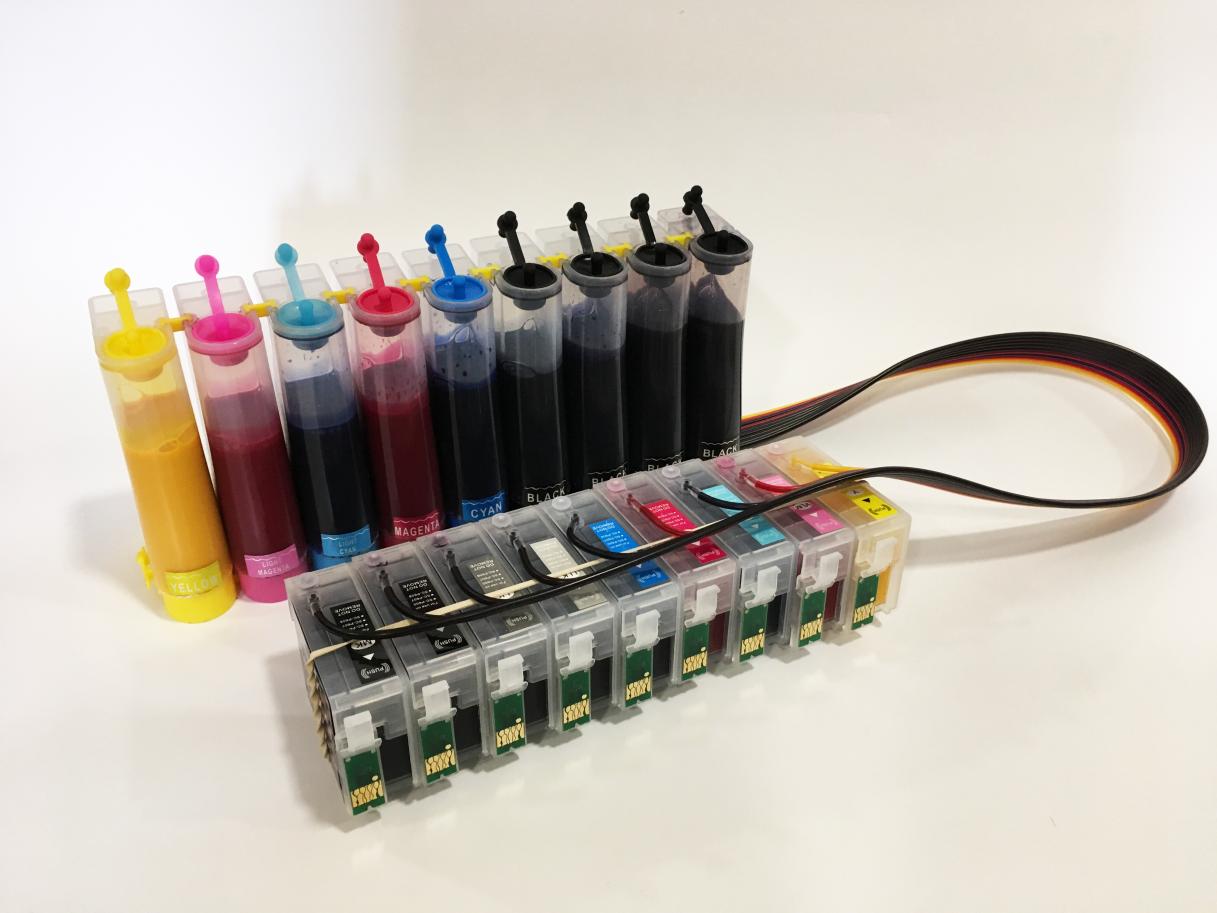

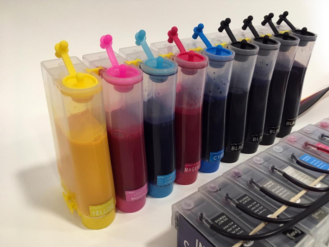

Ink System-
We started by making the ink system, we make the majority of our ink systems to order from component parts we hold in stock, This way we can spec our own system, tubing length and orientation of the tubes to make it as neat as possible. Once completed the system was filled with Inktec Sublinova Smart DTI sublimation inks included the Light Black (LK) and Light Light Black (LLK) inks.
Its been mentioned in a previous reply to this thread that the SC-P600 uses Matte Black (MK) and Photo Black (PK) ink channels, for this only the standard Black (BK) Inktec ink is required and both ink tanks MK/PK are filled with this ink.

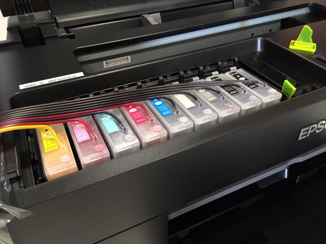

Fitting ink system-
With the ink system filled with ink it was on to fitting the system. As the printer was brand new we decided to fit the ink system for hte initial ink charge rather than the genuine Epson inks, this would mean not having to worry about recharging the ink lines to remove the standard ink and draw the sublimation ink through.
Fitment is extremely easy on the SC-P600, the ink cartridge cover is removed by pushing the cover to the left to 'pop' the hinge point. The cartridges clip into their corresponding slots.
We also have some neat lasercut acrylic inserts to press the microswitches to tell the printer the ink cartridge cover and main cover are both closed.

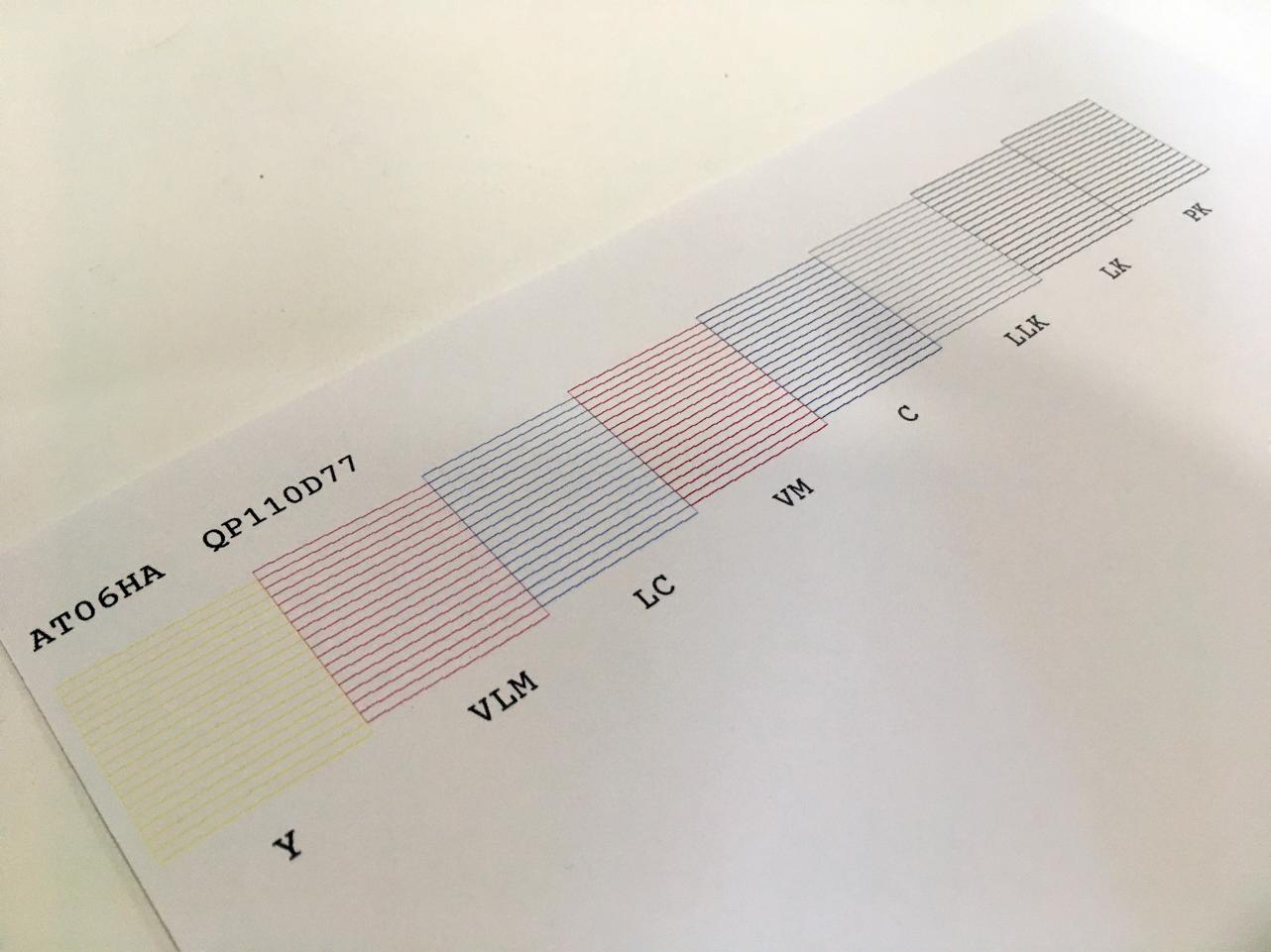

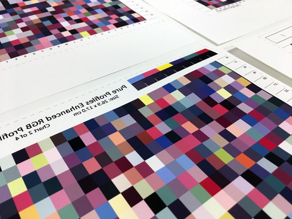

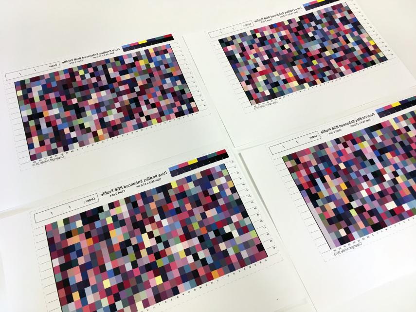

Testing and making ICC profile-
As expected the initial nozzle check pattern was perfect, we left the printer on the PK (photo black) ink channel choice. Other than allowing varying paper types to be selected there is NO need to change the printer from PK to MK ink channels, it prints exactly the same on both ink types and only wastes ink changing from one to other.
We have started to make the ICC profile as I can immediately tell the inks are too far from the original to allow the printer to be used without an ICC. We have decided to make a 'Premium' profile over a standard profile. A premium profile uses 4 swatch sheets in total whereas the standard only 2. Each sheet contains 510 individual coloured swatches so the profile will be generated from 2040 individual colours we hope this will give further improvement over a 6 colour printer such as the 1500W.
The profile swatch sheets are printed using the Adobe ACPU which is a utility to allow for colour management to be turned off, something that is no longer available on later versions of Adobe Photoshop. Having no colour management whilst printing the swatch sheets is imperative.

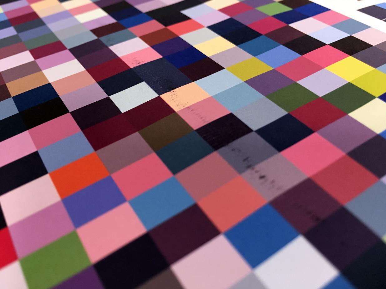

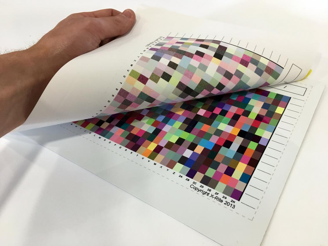

Profile Swatch sheets-
When printing the profile swatch sheets we set the printer to 'Epson Glossy Paper' (this is because the printer is using the PK photo black ink channel) paper choice makes no difference to how the printer prints. It just ensure the printer produces a good quality finish. ICM was turned OFF and quality was set to MAX Quality.
We did however find that on MAX quality the sublimation paper bulged and curled under heavy ink saturation causing scuff marks where the printing head caught the paper. This was simply resolved by changing to 'Quality' rather than MAX Quality setting.
Scuff marks from MAX Quality mode shown below-

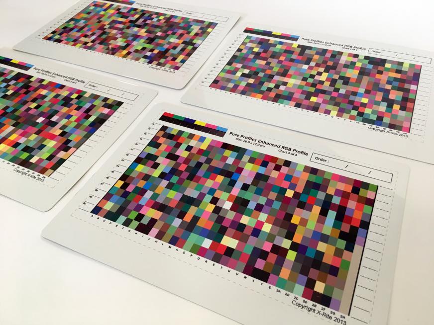

With the 4 sheets printed it was on to transferring; we opt to heat press out ICC colour swatches onto bright white sub coated aluminium sheets. These have the brightest, whitest coating and are also perfectly flat like a sheet of paper so are idea for sublimating on to for this purpose.
Colour swatches following heat pressing process shows a good ink release as we expected and good solid colours on each swatch. The 4 swatch sheets will now be scanned and a profile generated using the X-Rite color profiler. Hopefully we will have the ICC profile ready towards the end of the week and can then begin testing the printer and its capabilities on various substrates and papers (standard sublimation, high release papers and 3D film)
We will update you all as soon as we have further developments.
