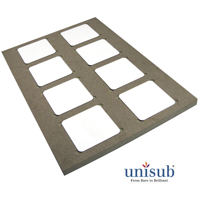

Re: Bms own coasters....
If you do so many coasters then i would never ever use the tape. Time spend taping would kill all the profitt.
You need a jig.
Tried. Tested. Thrown away. We even went as far as commissioning our own jigs but quite frankly still nothing beats taping down as very tricky to get consistent accurate artwork placement on the paper exactly where is needed for jig. Especially as you can't see the coasters when placing the paper onto the jig and even 1mm out could mean text/logo is not aligned correctly.

Post by John G »
We got a local laser craft company to cut one similar to Paul's example above, but to our spec. Yes it does take time to get the design placement bang on for the likes of logo's that appear close to the edge of the coasters. Certain artworks do need a tweek - but once you do get it right, you'll fly through the orders. We ordered 2 so when one is cooking, the other is having the paper taped to it - times in the press went up by about 10 - 20 seconds, but that could be our press.

@ paul & john
yeh fellas thats great....but i cant bloody well find any for sale ;(
@john - thats what i would like to do - have 2 - one cooking, other getting ready ;)

Post by John G »
You would need to get one cut to your spec as coasters from different suppliers differ slightly and may not fit the jig correctly. Try a search for "Laser wood cutters" in scotland and i'm sure there will be someone local to you. Ours are now past there best and warped a bit - next time i'd use a thicker wood and amend the design so it has a back to it, rather than holes straight through - this would make placing the coaster in the jig faster/easier.
Edit: just noticed Paul's example doesn't have holes straight through, that's how I'd get my next jigs made.
