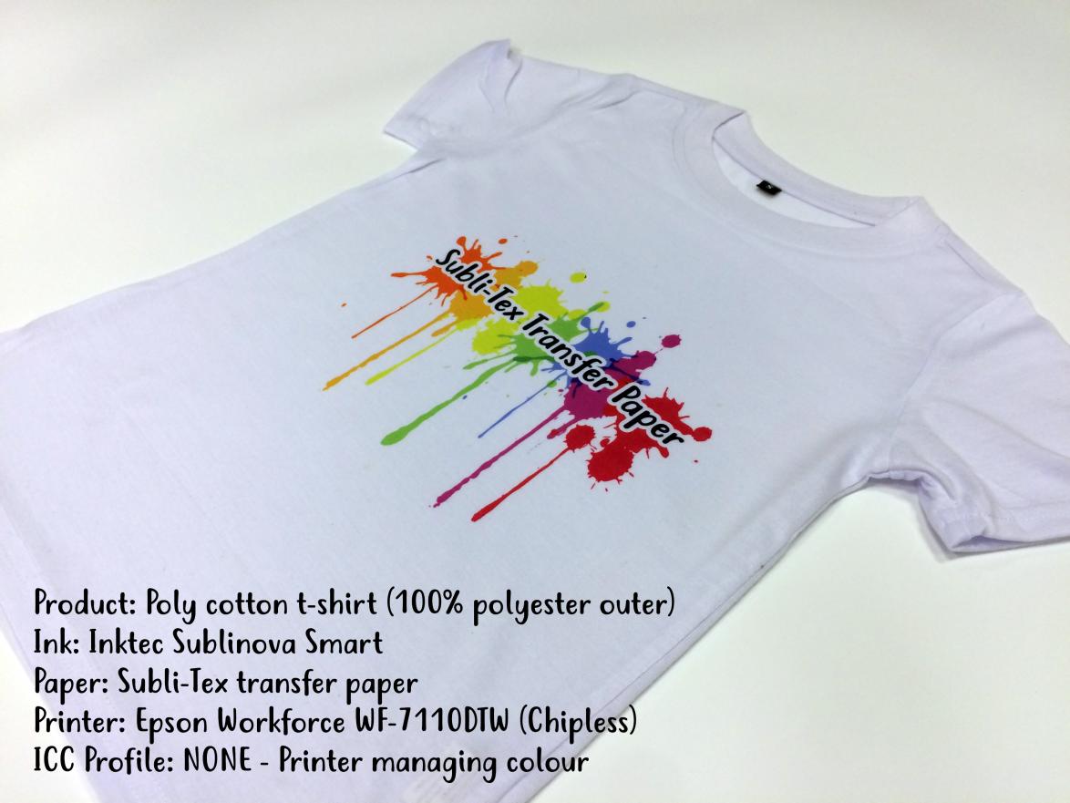

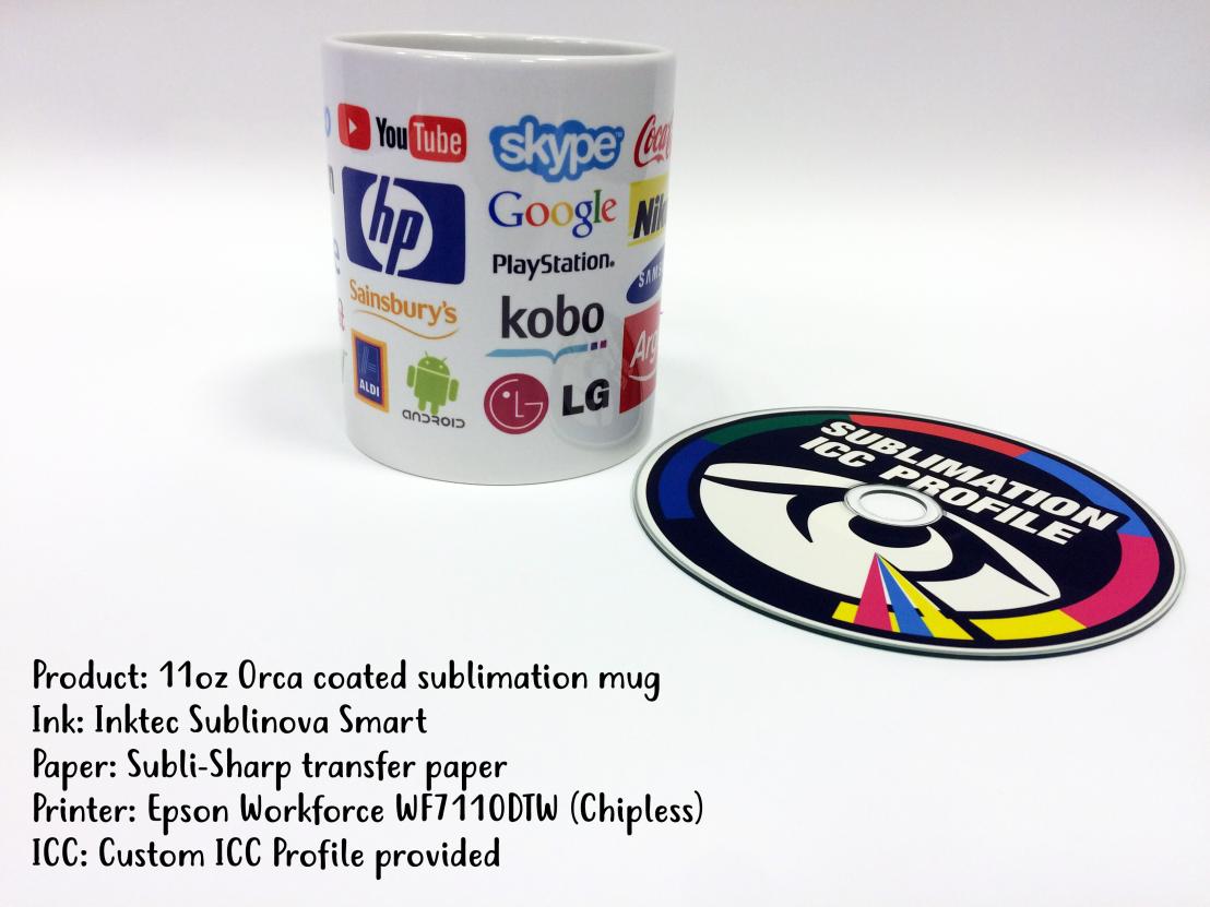

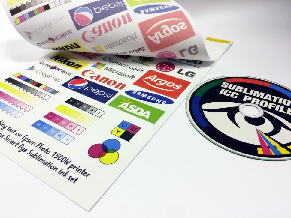

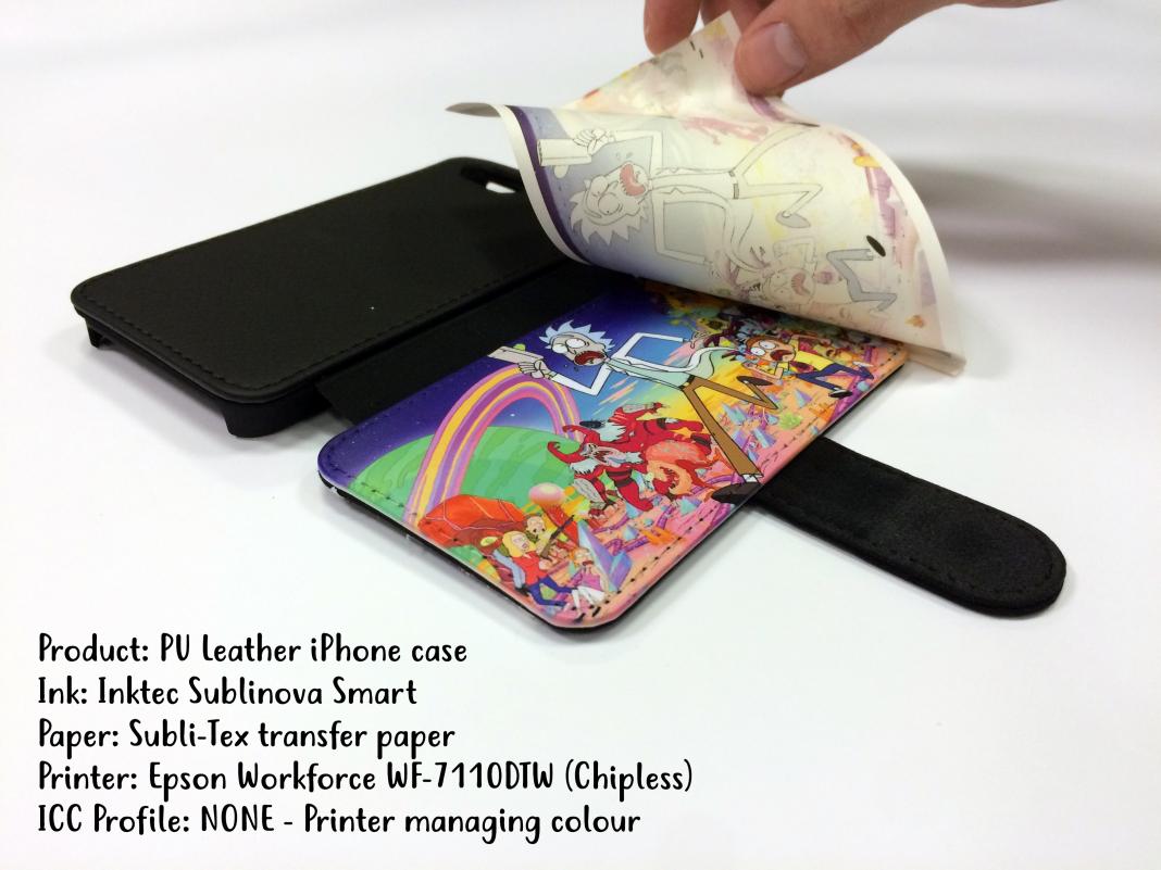

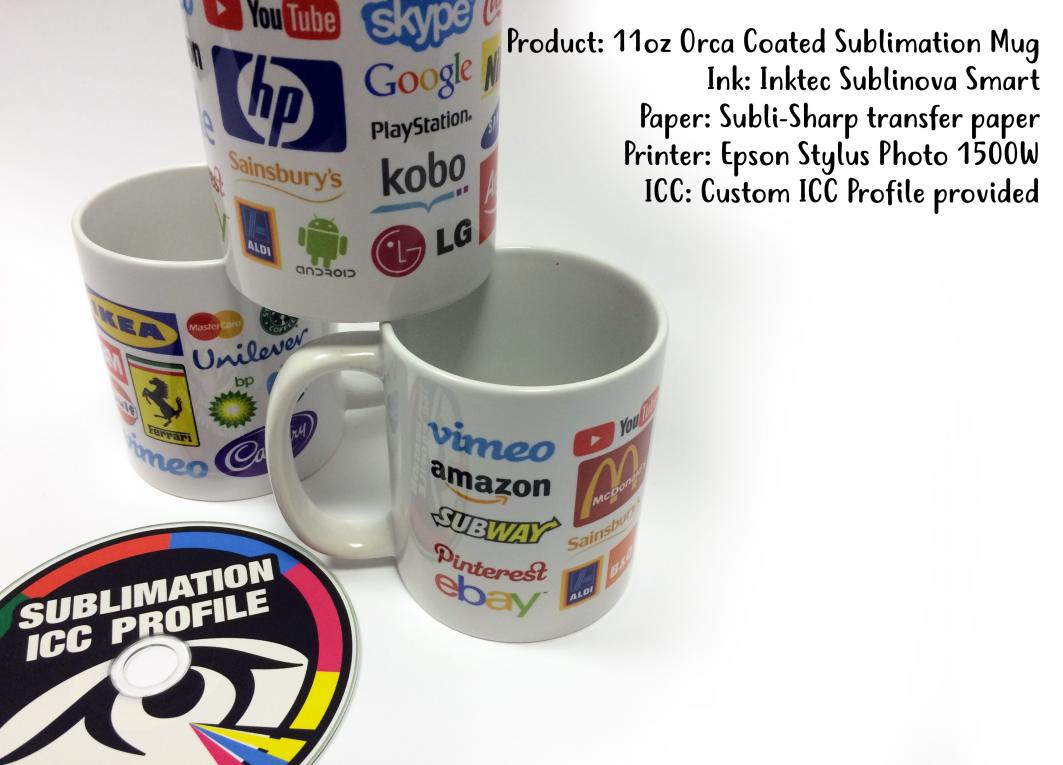

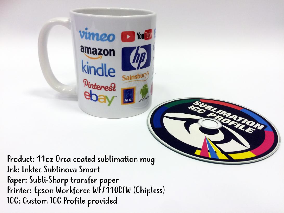

Here are some print samples from a WF7110 printer and a 1500W for comparison. Both printers are using Inktec Sublinova inks, custom ICC profile (that we provide for either printer), and Subli-Sharp or Subli-TEXTILE transfer papers depending on the product.
Christian
