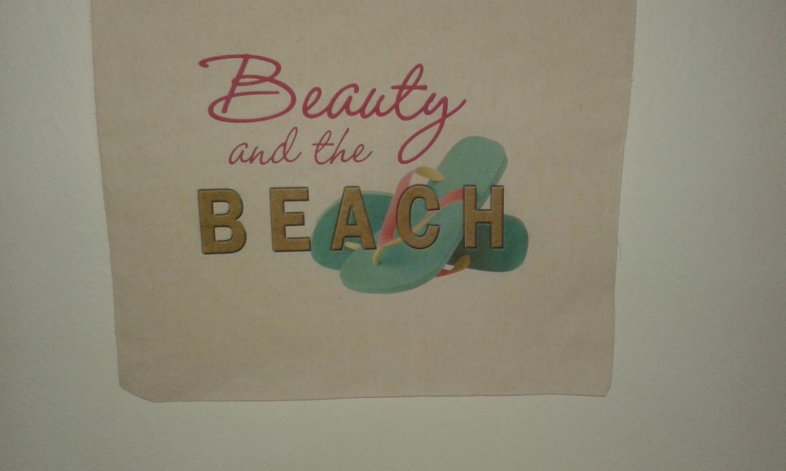

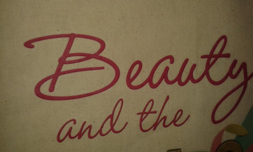

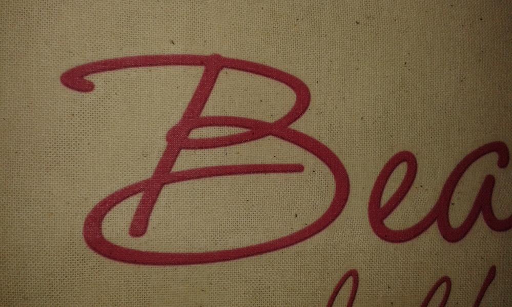

A few, admittedly not the best :biggrin:, photos of a design I lashed up in Photoshop, on the JetPro SS paper, printed with sublimation inks, and pressed onto a Tote bag -
[Right-click and View Image for a larger view]
If you look very closely, you may be able to see the parts of the transparent backing which I left in place to connect the whole design together, rather than messing about with application tape. Look between the 'B' and 'and.' Also between the 'B' and 'e' of Beauty. It's hardly noticeable on the actual bag and wouldn't detract from the final result, but does save time (and application tape!).

I should say that this design was cut right through and not 'kiss-cut,' hence the need to link it all together with 'bridges' of transparent backing. The backing is, in fact, white when cut but turns transparent when heat-pressed.
Re: What process/papers would be best?
Apologies again for the poor pictures. The bags are, in fact, a light cream colour and not brown!!!
