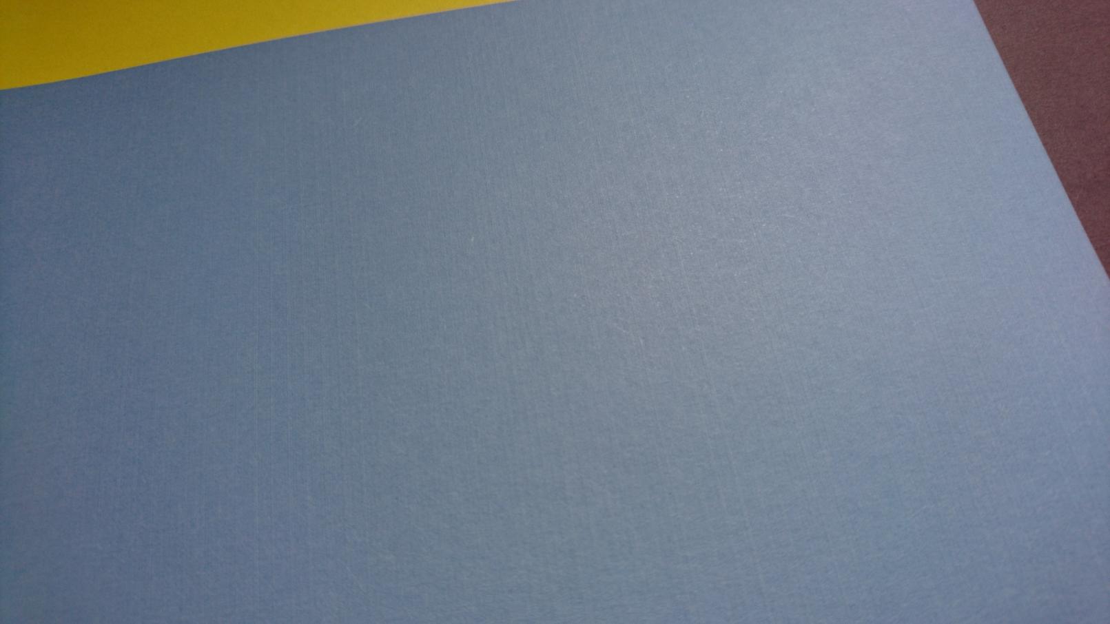

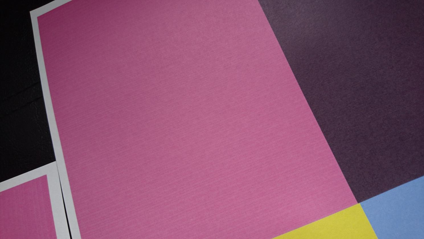

This morning I have resolved one issue, to cut a long story short the girlfriend decided to borrow some paper from my printer and put it back the wrong way up, so when I opened the fresh batch I mirrored how it was already in the tray.
Needless to say she's in the dog house. My fault for assuming it hadn't been touched.
However this returns me to my initial problem of banding.
I think ive exhausted the cleaning options at this point which seems to have fixed horizontal banding for others
[ATTACH=CONFIG]4498[/ATTACH]
[ATTACH=CONFIG]4499[/ATTACH]
- vB_ID:4499
- DSC_2618.jpg (98.91 KiB) Viewed 10 times
- vB_ID:4498
- DSC_2619.jpg (98.9 KiB) Viewed 10 times
Re: Ricoh SG3110DN white lines problem
:biggrin:Needless to say she's in the dog house.
If all that happened is the paper take out, put back in the wrong way round, then taken out again and put back in the right way round I am failing to see how it is the paper at fault for the banding.
I appreciate that when you used different paper it was perfect, its just that none of this is making any sense right now, which must be a huge pain for you
No no, the banding was my initial problem, but between me spending 2 days trying to fix it, the girlfriend took the remaining CIE paper out of the tray to borrow some, not realising it has to go in a specific way as its special paper, so when I opened a new batch of CIE paper I put it in the same as what was already in there, as in my head i had already done half the ream with no problems so didnt think it could be up the wrong way round, hence why the problem continued and I mistakenly blamed the CIE paper.
The subright paper worked as I put this in the correct way.
I have sent a very apologetic email to Shane at CIE.
Now that the CIE paper is back in the correct way I have the initial banding problem which was masked by the poor quality printing on the wrong side of the paper.
I guess a CMYK test on subright would be a good thing to do a this point to see if the banding is consistent across all paper types
