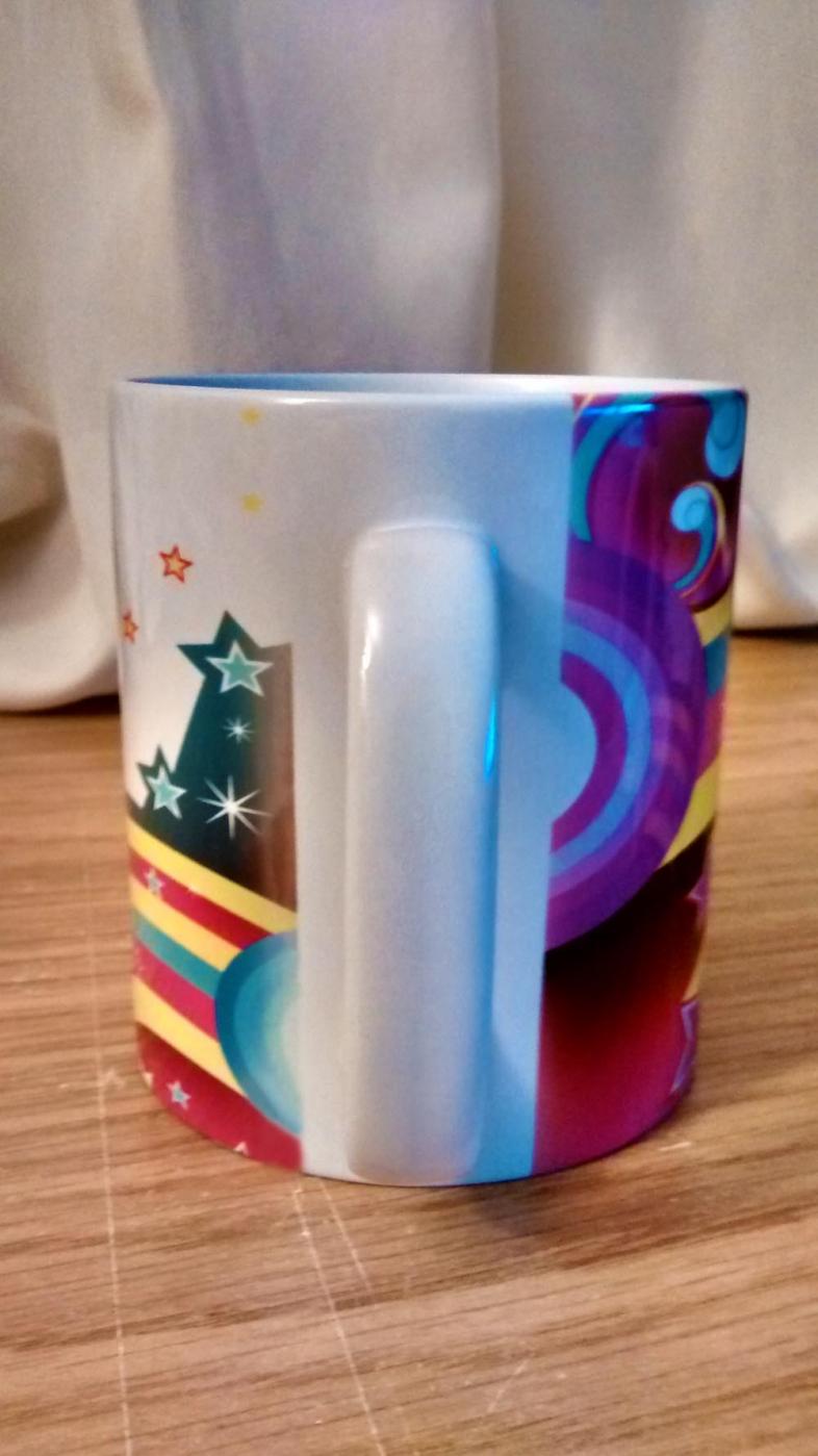

as promised..
full top to bottom coverage with no bleed over the top lip of mug...no fading at handle edges, top or bottom...my crappy phone camera quality is....CRAP !....and i cant be assed getting the big canon 700d out for this...sorry :rolleyes:
distance from handle - 6/7mm.
gonna try one tease it for one more and see if i can tighten that distance margin from the handle in more
Re: double mug press
oh well....
got it down to MAX of 5mm either side.....again, no fading,top, bottom or around the handle area....sorry from crap phone camera.
but tbh, the last one i posted, i feel a lot more comfy with selling/doing than this tighter one
this was just a wee test for uncle simon lol
it can be done on the double mug press
bit to the left is the flash/reflections not fading marks

so for the real world test, 7/8mm either side of the 10oz mug handle will work no bother, with this double press anyway, others i cant comment on
