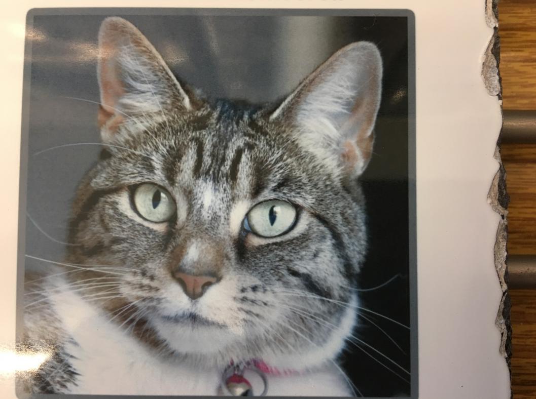

Re: Photo Slate Coating Changes :(
Sorry for the delay. Here's a pic' (I've cropped around part of it as my designs have a habit of being copied - I'm sure nobody here would do that but this is a public forum).
I spoke to Longforte and they say they they use NO pre-heat (on a flat press) and cook for 8 minutes. I use 3D and that doesn't work for me.
This one was made in a ST3042 3D machine.
Preheated for 8 minutes and cooked for 8 minutes at 200c.
It's not as nice as the original coating but I've not had any complaints so far.

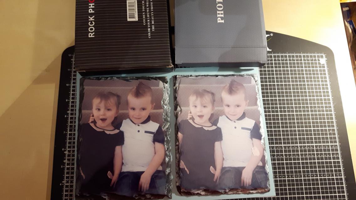

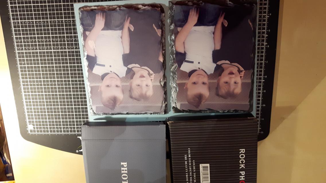

These are 2 slates I have printed recently - using the same exact process both times. One is an old slate I had from a previous order the other is one of a new batch. You can see the difference immediately. I have bought from 2 differenct suppliers and are getting the same results with the new ones.
I am going to send them back as I can't do anything with them.
