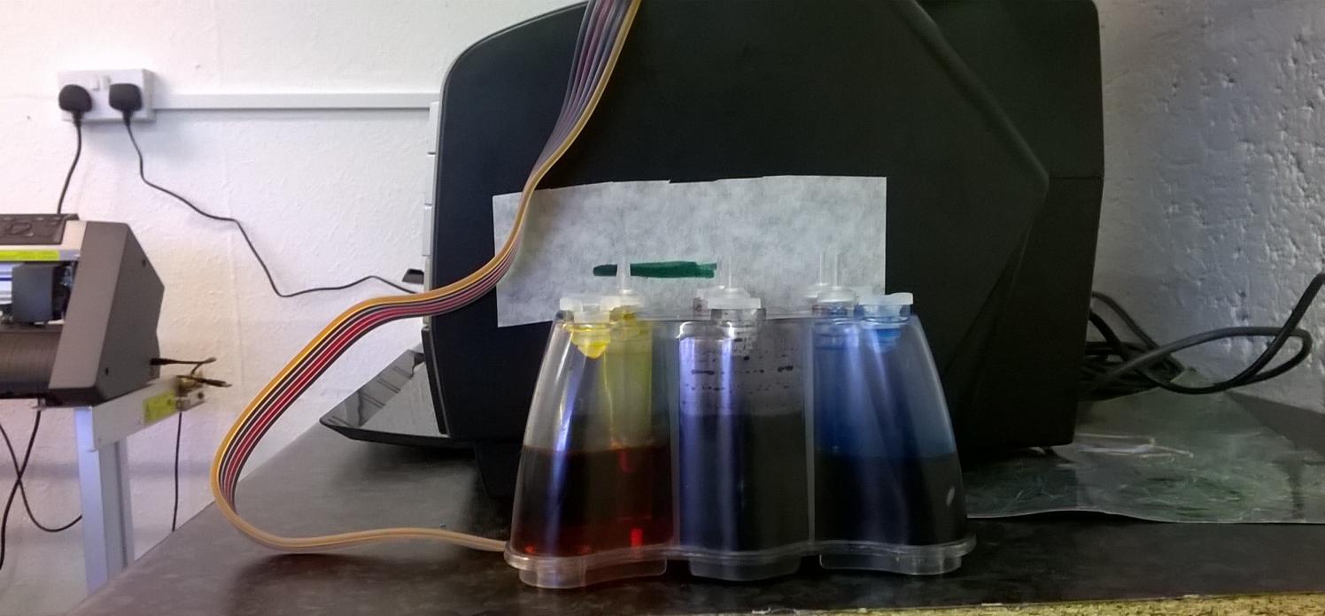

The photo below shows what I mean by City Ink Express's ciss being too stubby. The green line on the 1400 shows the level of the bottom of the printhead. This one is full of dye based ink, but I also have a 1500w for sublimation with the same ciss. The bottom of the printheads on the 1500w are very slightly lower than thoseon the 1400, but it is still a problem.

As the ink is fed from the bottom of the bottles of the cis I cannot see what difference the height of the bottles makes.

It will very slowly syphon back into the tank, from the cartridge. Probably not fast enough if you are using it every day, but I was having to charge it too often for it to be tolerable.

pw66;116822 wrote:It will very slowly syphon back into the tank, from the cartridge. Probably not fast enough if you are using it every day, but I was having to charge it too often for it to be tolerable.
Exactly what was happening to me and very infuriating. Also, there were a couple of times the sticky pad holding the ink lines to the top of the print head came loose and I thought I'd broken my printer!

webtrekker;116830 wrote:Exactly what was happening to me and very infuriating.
Raise the level of the ciss gradually. Like I said in an earlier post, I use two Screwfix catalogues to get the right level.
Don't over do it, or the reverse might happen. You could end up dumping ink into your printer.
I had a similar problem with the sticky pads. I used some Very High Bond tape ( MDP sell it ). It is expensive, but I use it anyway so not a problem for me.
