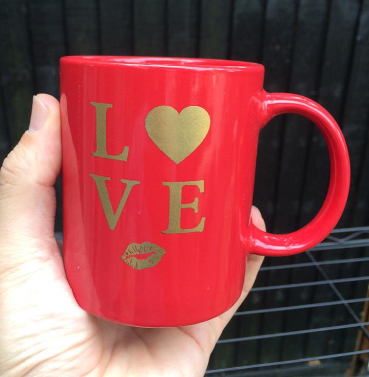

Re: How to use transfer paper - Gold?
Update - We got hold of some of this metallic paper and some regular mugs (thank you Tesco!) and this is our very first one done just now. Design a bit naff and too small but works a treat just like Forever say. Print onto BLACK toner and press at 160c for 180s. Will put in a few dishwasher cycles to see if it will be ok or if handwashing advisable.
