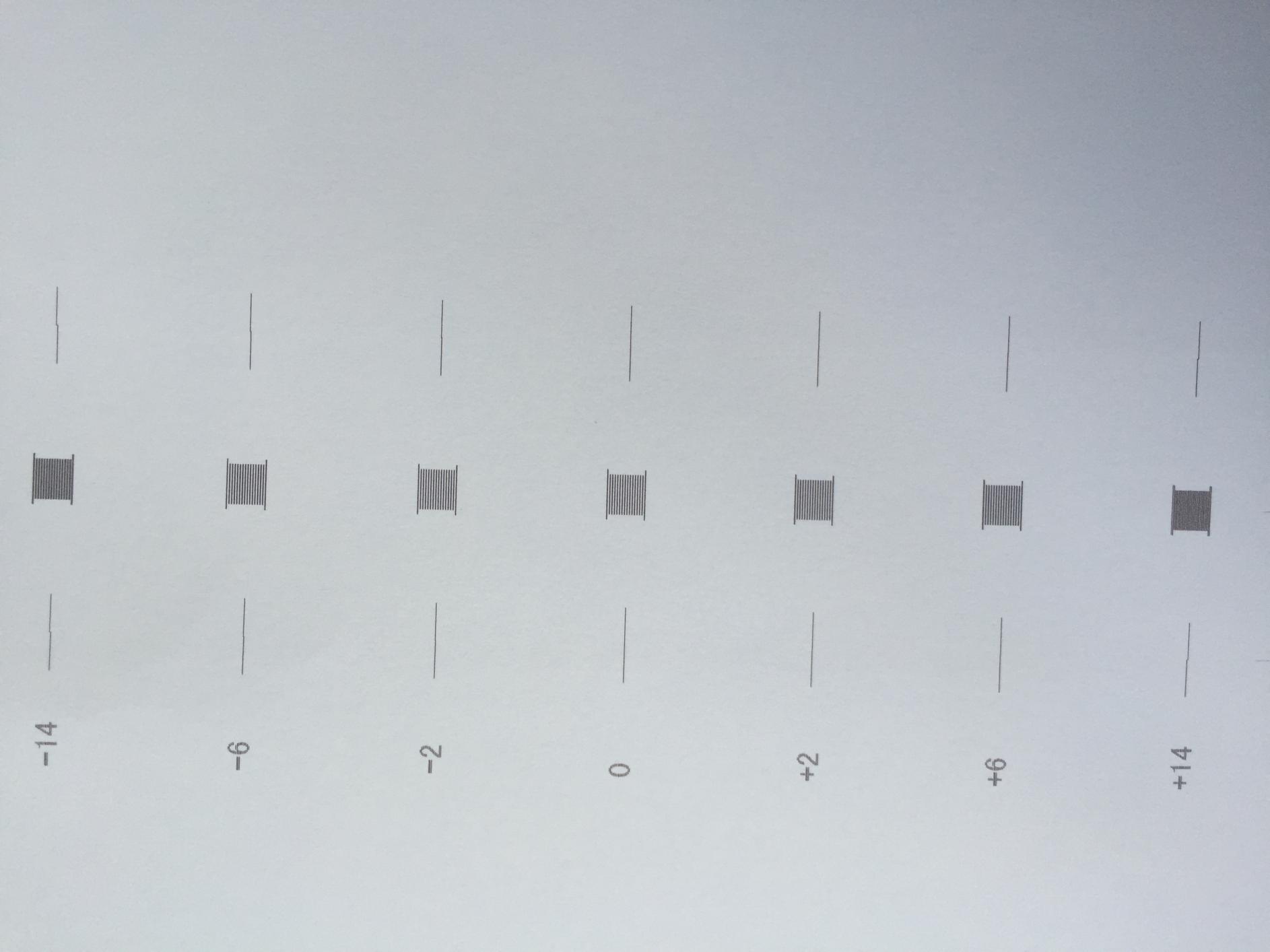

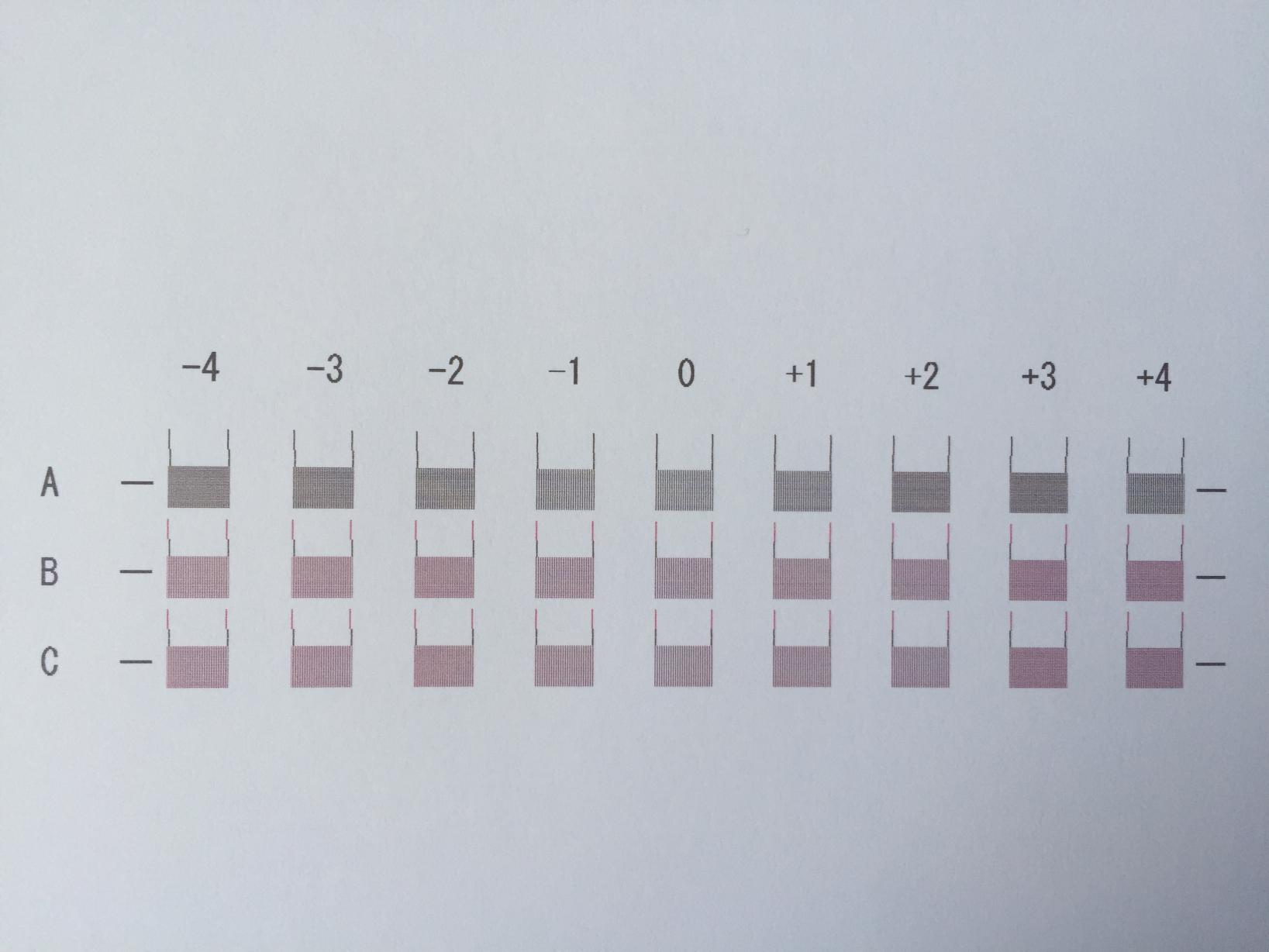

Hi Justin,
Thanks for the message. I have just gone through both the Adjust Print-head Positions and Adjust Paper Feed tests again. For the Print-head Positions i kept everything at 0 as these seem like the straightest. For the Paper Feedi also kept it at 0 as this again seemed the straightest.

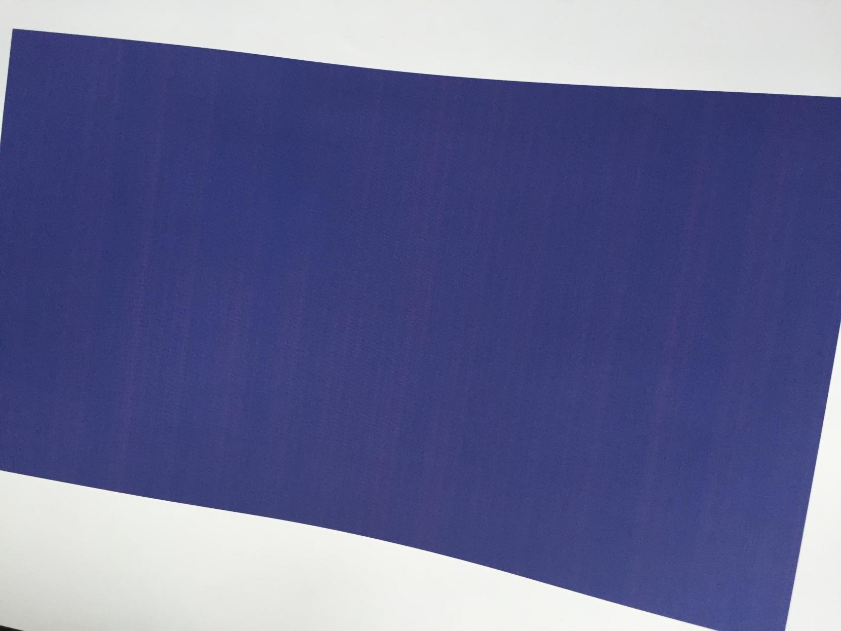

So i uninstalled both the printer and power-driver this morning and gave everything a fresh install and setup, including the photoshop colour profile settings. Sadly, this didn't make any difference to the print and the banding is still visible in the lighter colours (mostly the blues).
I was however reading through the Sawgrass technical support and they advised doing a few full page colour tests on regular paper instead of sublimation paper and to my amazement, the regular page prints out cyan perfectly. There's no visible banding at all.
As soon as put the sublimation paper back in (TruPix Classic Sublimation papaer from Xpres A3) the banding starts again.
If i do the full page colour test on the sublimation paper i get banding. What a nightmare.
I have also tried full colour page prints of the Yellow, Red and Black. The Red and Yellow are absolutely perfect, not a single line out of place or banding of any kind, just solid colour.

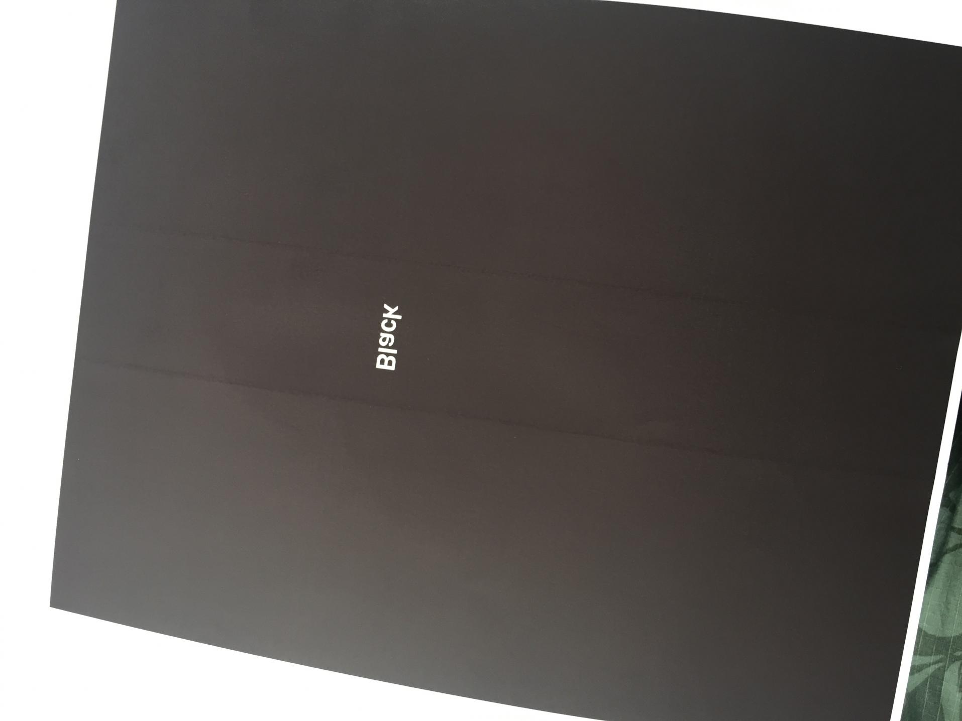

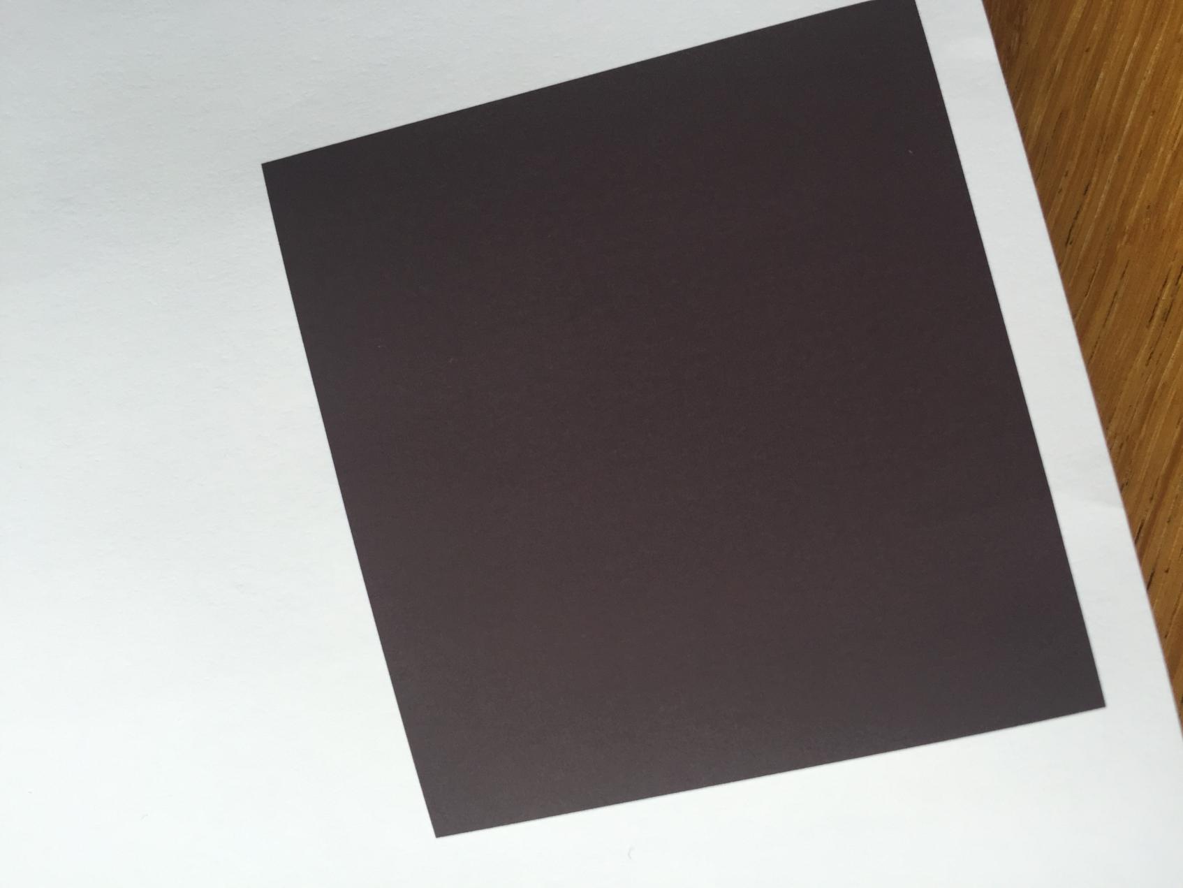

When it comes to the black, printing a full colour test page from the printer itself instead of from photoshop renders the blacks brown but printing as i would do normally from Photoshop + colour profile settings produces black, i'm not bothered about this as it's only a for the test. I can see a little banding in the 'printers black full page colour test' but very little if i print black from photoshop.

I thought i'd install the printer and power driver on another machine just in case it was my own PC that was causing the problem but nope, didn't change a thing. Anyone ever experienced anything like this before? Its now started banding on lighter colours like red and orange also :(

Re: Horizontal Lines / Veritcal bars on prints using Ricoh Printer SG7100DN
I think this is the printer, speak to Sawgrass and tell them it's under warranty and you want it sorting. These previous models have had banding issues resulting in replacement being required.
