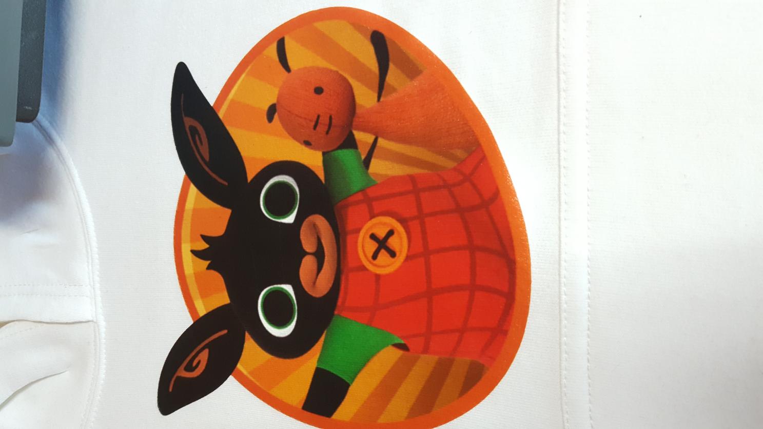

Last week I asked socialgiraffe for a practice sheet of the T-one to test on my own family. anyway as usual few days later on my door step it arrived all packed nice and neat. I had a white AWDis hoodie and printed the image to the front.
The paper was similar to look at at as a few of the other well know papers I use but to hear it is a one print only opens a few eye. I pressed it to the hoodie for the 5 seconds. then pressed again using the other paper. The print came out great and peeled back very easy with no issues. I need to do a few washes with it now over time and will report back.
