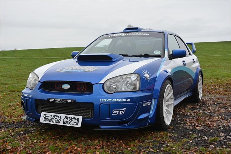

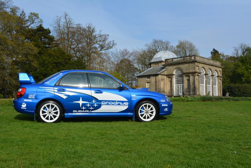

Authur, it will do the job fine or something like the KPMF 7000 cast which is a good cast vinyl, depending how much of a cruve it's going on!
Just make sure he cleans any wax/polish off with something like a IPA or it will form a barrier between the paint/vinyl.
This is 651 that's been fitted for about 6 years now with no peel anywhere This is a mix of 651 and white KPMF 7000, 7000 used for the curve over the rear arch

How was that cut, what machine was it cut on?
