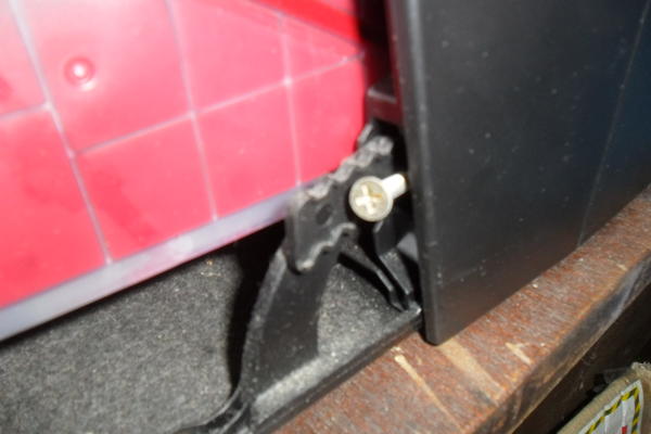

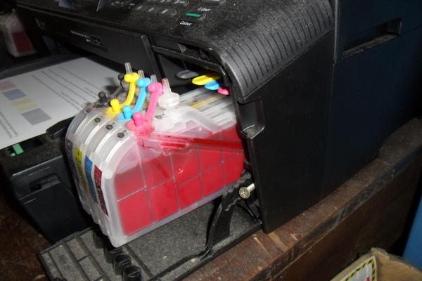

I've been using the 6510dw brothers for years. Basically the same unit.
Here's how I solve the problem on all my Brother MFCs.
You set the little plastic trip thing so it fools the switch, then hold it in place with a screw.
Has no effect on removing or replacing cartridges..
