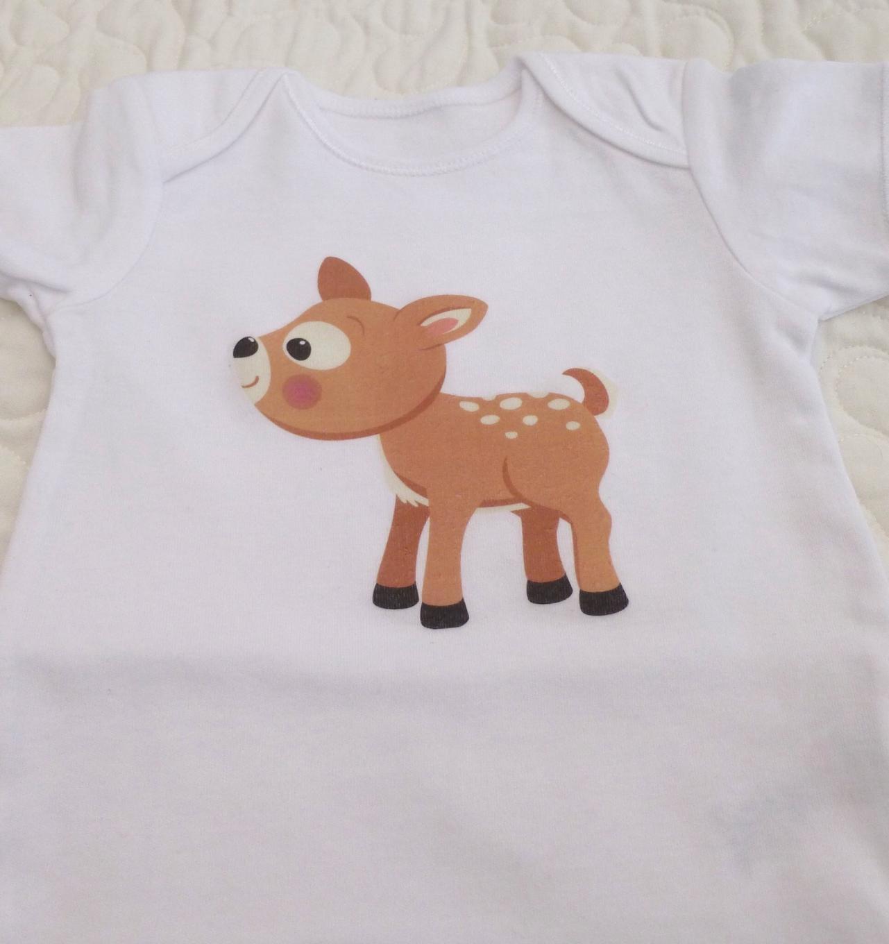

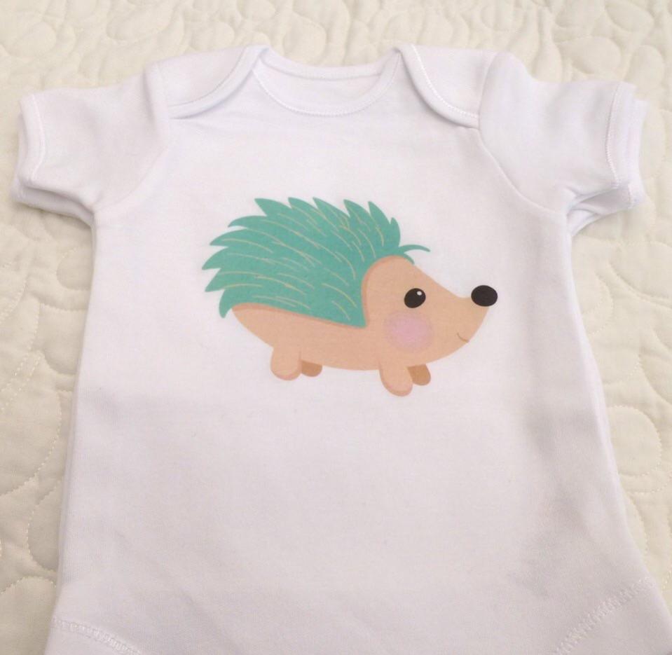

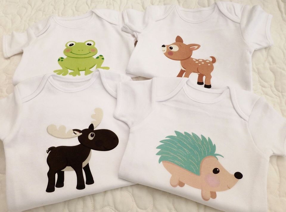

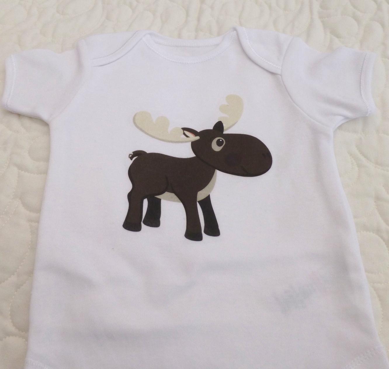

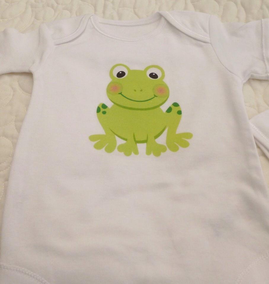

Forgot earlier, I got to play with my OKI 610 and TTC3.1 and had success. 8/9 pressure, 180C & 12 seconds.
I think my mistake was upping the temperature when I did not get the clean peel, reducing the time seemed to be the trick.
Anyway here is some picks. Nothing special just some baby grows. Cute though :rolleyes:
Kath

Your TTC prints look ace and very cute Kath. Glad you got sorted with time, temp, and peel.
Re: SawGrass Virtuoso 800
All your prints look great Kath and now you've shown me a new option using the TTC paper. I'll have to contact their Australian store and see if my printer will work with this paper as I can't find much info that relates to my printer about this. Thanks for sharing
