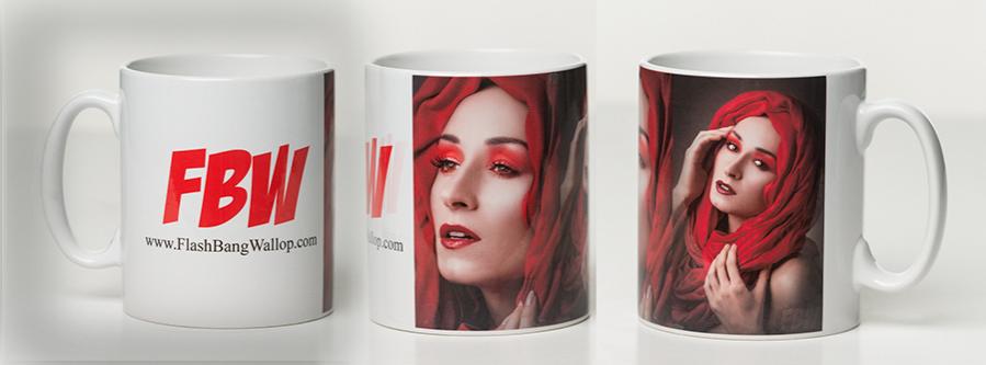

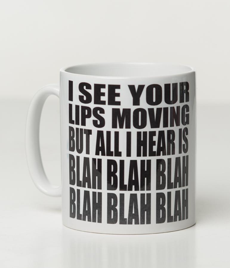

and then.....printed first mug. Heavy black letters - little bit brown but nice and sharp
reduced baking time and tried it with a couple of images (I dabble in photography) and ....am blown away

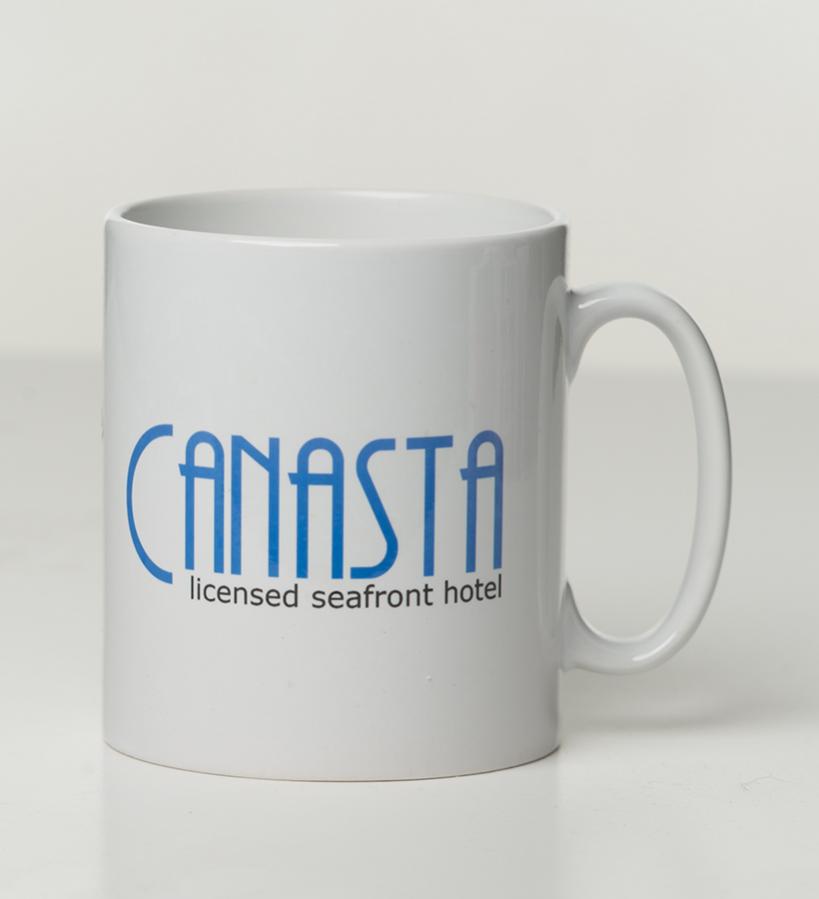

Ok, as above, Im very pleased with how the first 6 turned out.
First black text one I tried was overbaked so reduced temperature by 20 degrees and next one was perfect.

So for my first mug I thought I'd better follow that. I just put a design in with some plain thick black letters (impact font) to see how it would cope. It was brown.
So then I thought I'd set the high temp down to 310ºF and tried it with an image - the one with the red scarf. I was very pleased how that turned out
Tried about 6 different designs and have yet to find one that isn't good enough to sell.

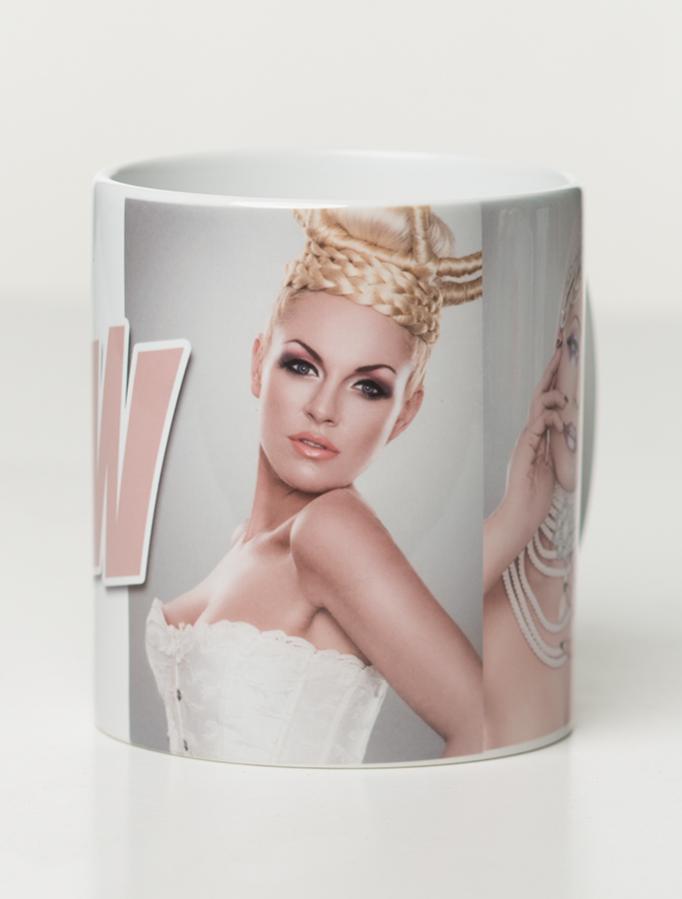

Only errors I made was not being careful enough in making sure the design is dead level at bottom of cup.

I see you are printing virually the full height of the mug, out of interest what mugs are you using because I struggle big time doing this sort of coverage with my press and mugs (and I've tried a couple of brands) I always seem to get fading at the base edge

AlanD they came as part of package linked above. Orca Durham is on the box. I did follow advice given elsewhere on here on first few mugs to pre heat the bottoms by placing them on a grill plate but to be honest....am not sure it needed it with this model. Will do some more tests on Boxing Day without pre-heating. MagicTouch didn't answer my question, pre-order, whether the elements were more evenly spread on this and I didn't push for an answer. I guess the test on Boxing Day will inform us better. I'll do a full height one and post the result here.
