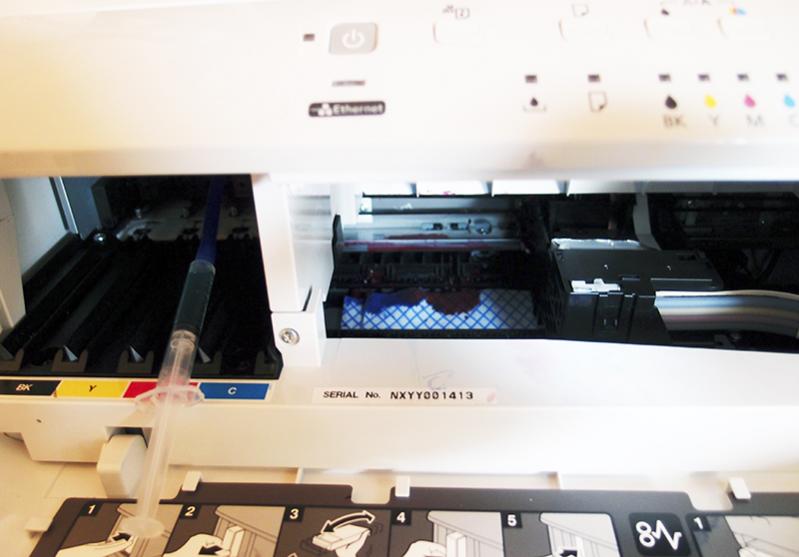

I'm trying to rescue an Epson Workforce 4015DN which suffered from a problem with the cyan. Since I had already tried the head soaking and cleaning cart methods using IPA and Glycol, I tried the direct print head flush method. These Workforces aren't exactly maintenance friendly.
When I injected some fluid through the nozzle where it meets the ink cartridge on the left hand side of the printer, the fluid didn't pass through the long ink lines but flooded out the back. Tried the same with the magenta just out of curiosity and it also flooded out the back. I had already written off this printer after the cyan leak!
Do you know why this happens? Is not possible to flush the lines on these printers? I've attached a picture.
Thanks,
Gary
Thanks,
Gary

Re: Epson Workforce Head Flushing
Flushing it through the heads is never good! In my case above, I reckon the heads were sealed until the printing operation starts and then they open up. I couldn't understand why nothing was coming through, then I noticed that the ink lines had swollen and were about to explode with cleaning fluid. Sometimes it makes economic sense to buy a new printer just to start earning again asap.
