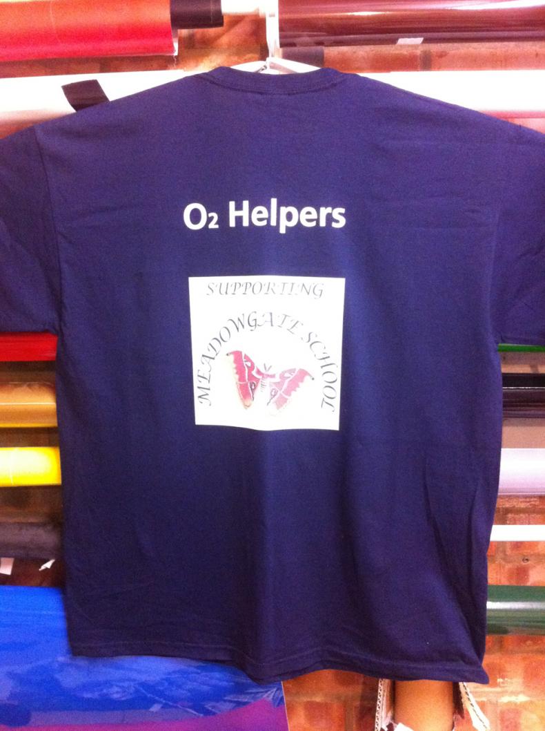

[ATTACH=CONFIG]970[/ATTACH]
Many thanks martin recieved the paper.
Here is a picture of the results.
- vB_ID:970
- IMG_1482.jpg (95.85 KiB) Viewed 484 times
Re: Advice please
hmmm.... i would do lettering in vinyl and butterfly on paper. but i would also cut it out so there would not be able white background. my opinion.
Re: Advice please
Yeah I did suggest that to them but the wanted to keep the text blue as its there logo colours and it would hAve got lost on the blue top. Plus it made it stand out on as that's the main reason for the t-shirt.
Just took it to them and they was over the moon.. Was a relief hopefully will bring more work. They are going to hand out my flyers for the whole 24 hours while they do the bike ride for doing the tops. Happy days
