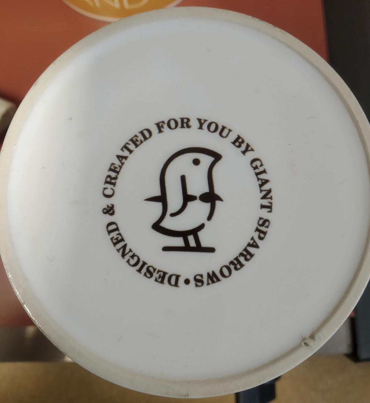

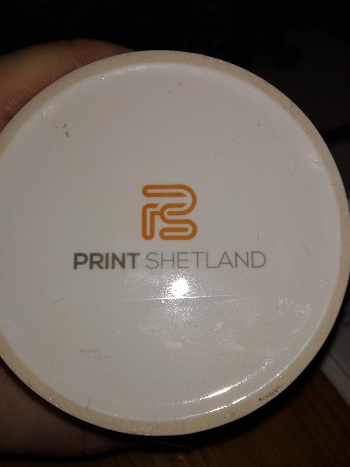

Attached a couple of images we did via sublimation that came out OK, consistency was an issue.
We have been thinking about starting to offer a service to brand the bottom of customers mugs for them as we have other ways in-house it could be done. Obviously the logistics of sending mugs is difficult due to high prices but if we can work something out we may start offering it.
If anyone is interested please drop me a PM.
