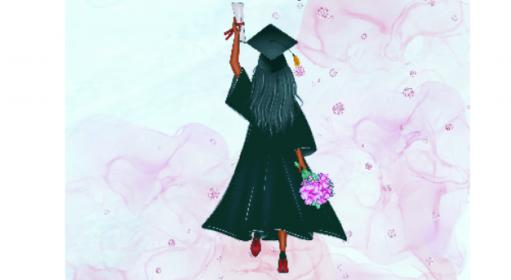

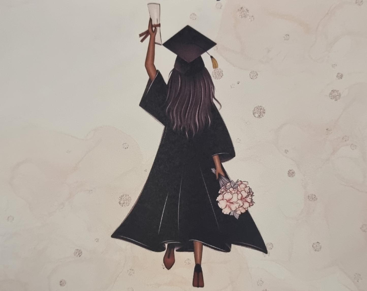

Designed in Canva (image 1) and saved as PDF. When printing straight from the PDF we are aware there are no ICC profiles being used (at least with Canva anyway). We print on Versa paper from IE, using Sublinova Inks. When printed the colours are very similar to the screen such as the pinks and cream/ grey background (and are happy with what we see generally). However the print for the graphic in the middle in black (image 2) is mottled/ blotchy on the print alone - no pressing as yet. We are aware that there will be differences from Image on screen, to when it is printed, to when it is pressed. But this part is supposed to be jet black or at least black, but when printed you can see it is slightly browny/ blonde and not so black - This is where we feel we should use a design software in order to utilise the ICC profiles we were given - but had not done at this point.

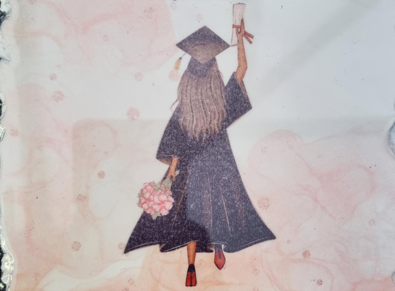

When pressing onto slate (image 3) you see the graphic doesn't look black and is very mottled, and now looks blonde, even the gown.
Having looked into this more, reading through the forum, we are aware that using the ICC profiles is best, but for that we need to use some kind of design software. We didn't have any as such, so just downloaded GIMP, (the ICC profiles were already installed onto the laptop when we initially got them but again doesn't work with Canva). With GIMP we uploaded the same image here in order to print. initially the colours and everything on the screen seemed to be fine and matched what we wanted and that found on Canva.

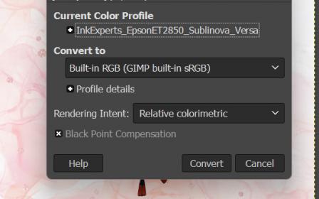

We next watched a tutorial for installing and using the ICC profiles on GIMP (image 4). When we did this, initially it seemed fine, converting to the chosen ICC profiles however when looking at print preview (image 5) it clearly looks like it has different colours than what it should look like.... to us it looks like it is purple instead of pink, and turquoise green/ blue instead of cream/ light grey.
We have read on here that sometimes the print preview image can be different on screen to the actual print and the instructions were to print first before coming to any conclusions... However when doing this, the same colours presented on the print preview screen (that are different to the image on GIMP) were the same purple and turquoise green/ blue shown on the printed paper.

195 temp for 550 sec - image in middle mottled and does not look black (image 3 again)

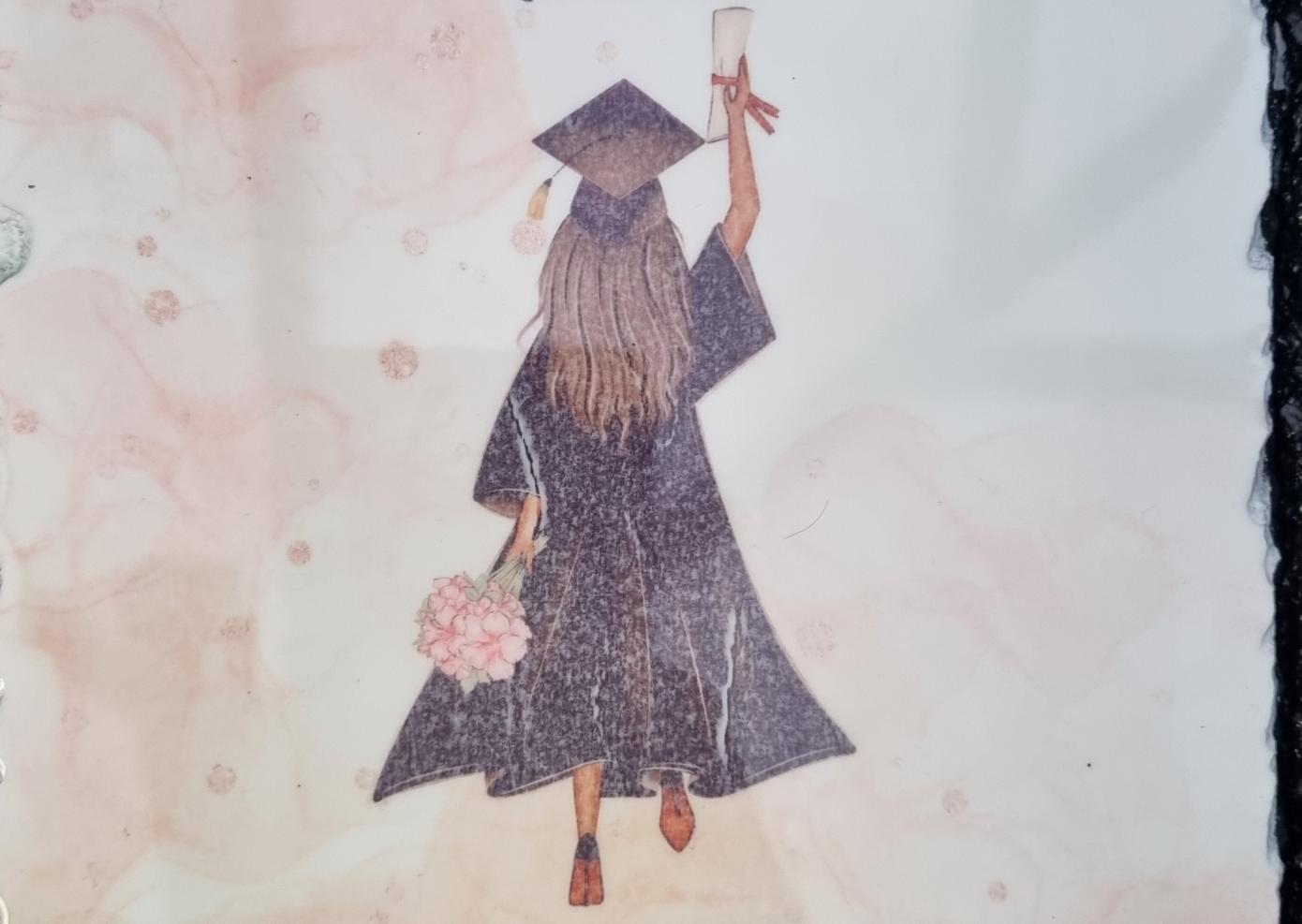

Next went for longer - checking in between... 195 temp for 600 sec, had a peak after this time, checked to see if same issues were present (which they were), so cooked for another 60 sec, checked again still the same, and then cooked for another 60 sec (720 secs in total) (see image 6)

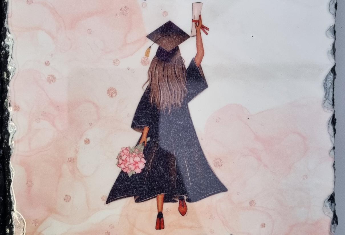

Then finally thought we'd do less time whilst checking... 195 temp for 400 sec initially, checked to see if same issues were present (which they were), cooked for another 60 secs, checking again, and then cooked for another 60 secs without any luck (520 secs in total) (see image 7) :eek:

That screenshot showed that we changed from GIMPs normal settings to the chosen ICC profile, and that the current profile was the ICC for versa. And also that GIMP handles the colours, and not the printer.

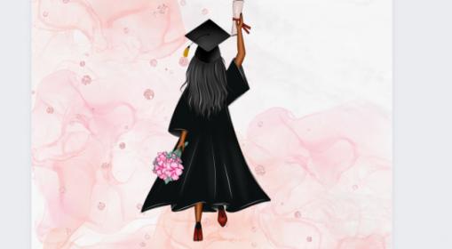

We still feel there are issues with the ICC profiles as the colours are not correct. If you look at image 2 - the print out looks almost brown/ blonde and not black. This is what initially made us think that we needed to use ICC profiles for sure, and when we did, the colours all changed.
Any suggestions? Happy to share screenshots etc of the prolfiles, and print settings.
