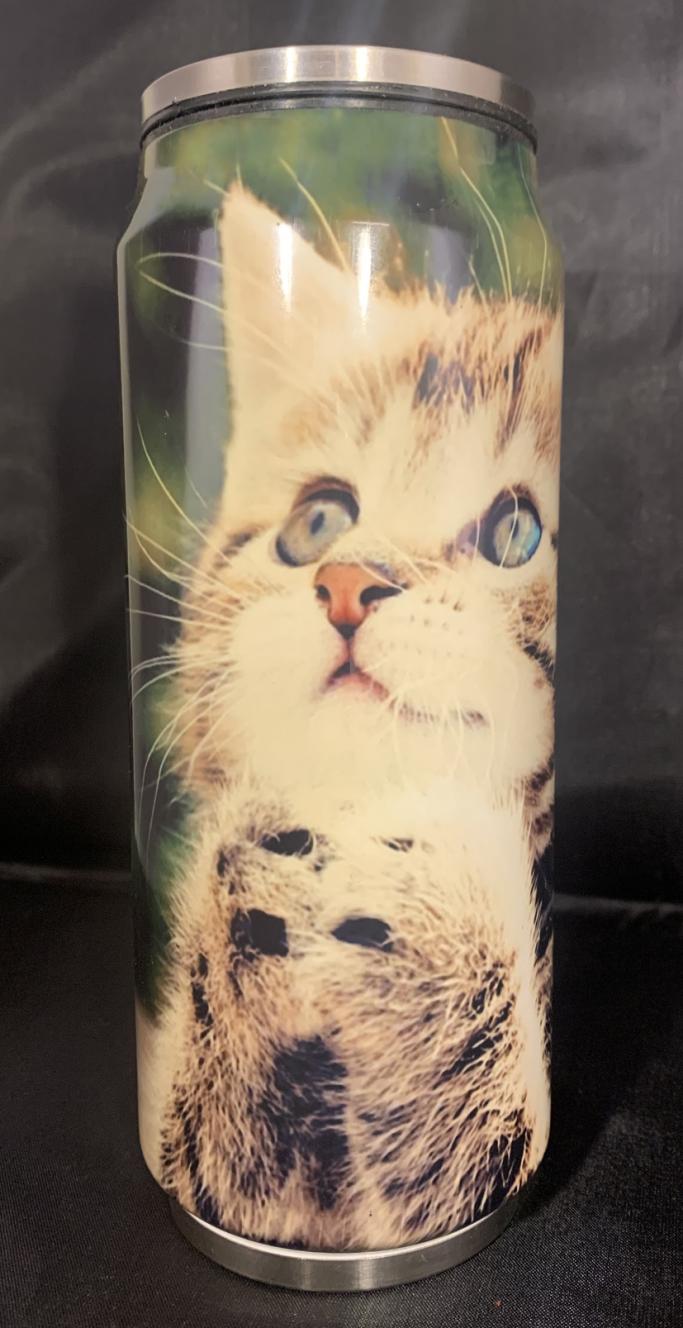

Personally I stick to ovens and heat shrink these days as it is the only solution where you can say yes to pretty much everything. You can get full coverage all the way round and on certain items you can also print on the taper (see picture which is of a reject water bottle)
[ATTACH=CONFIG]6664[/ATTACH]
My Genie III is only used for toner transfers on to different coloured bottles such as blacks, reds etc. etc.
