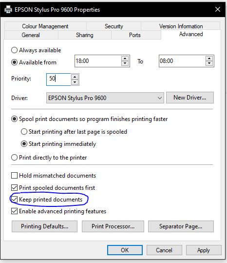

[ATTACH=CONFIG]6395[/ATTACH]
Circled is the keep printed documents - so you can just keep clicking reprint
You can also see the schedule option at the top, to set the print queue to only run for certain times of day
Also, priority (1-100 available) which print queue is most important (If you right click on individual print jobs in the queue, you can assign priorities per job - once they're in the queue, so if you need something quick boost it to 100, and it will come off next. the default for all jobs is 1, so easy to reorder what comes out.
