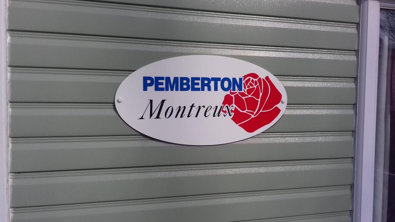

I've not got a lot of experience in sign-making but I did get around to making a new sign for our caravan from white acrylic with sign vinyl (5 to 7 years) from MDP. Made a good job that seems to be standing up well to both hot
/sunny and wet weather.
