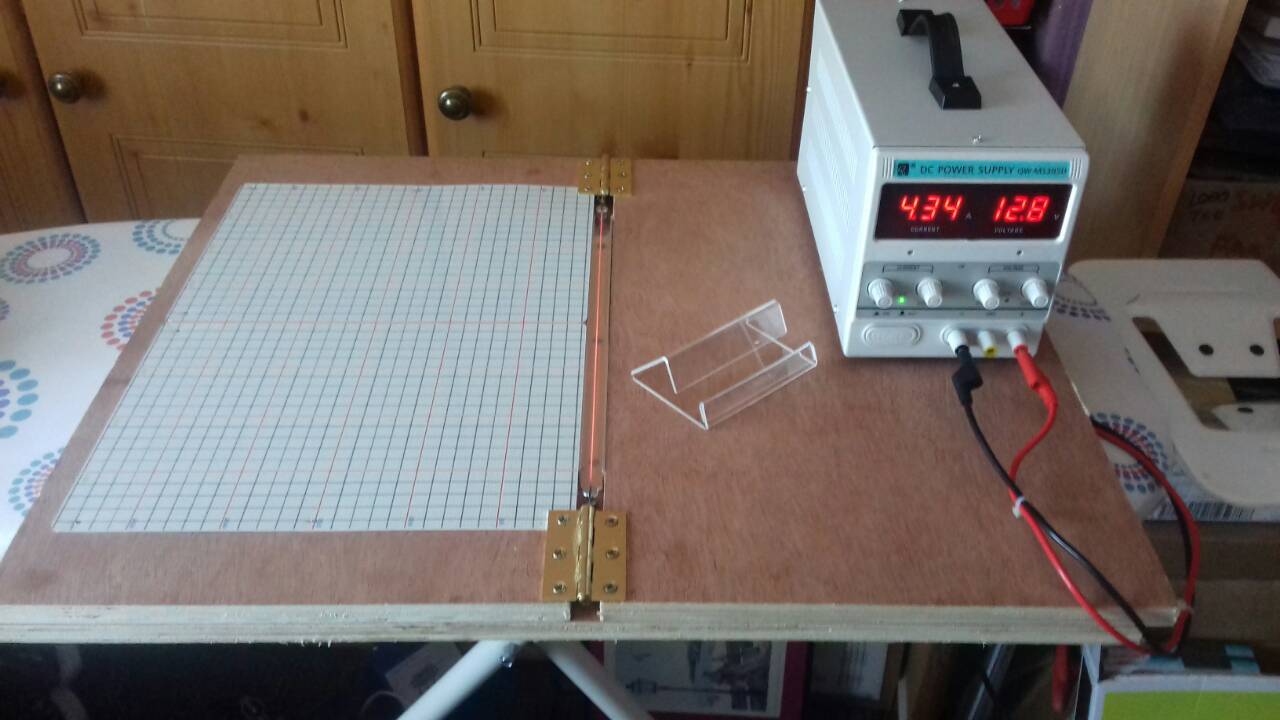

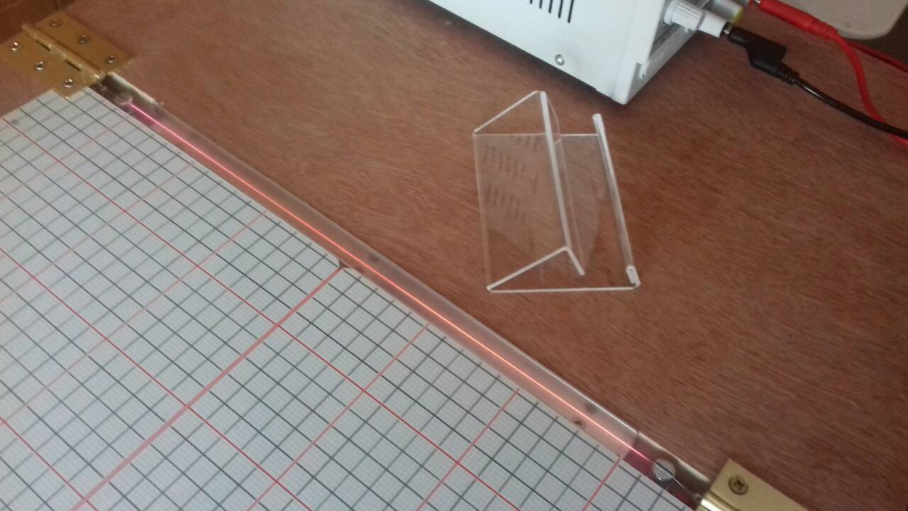

While I'm here, here's a couple of pics of the bending machine I designed and built. Bit rough around the edges but I'm already working on a MkII version with a better finish and a few improvements. I'm even toying with the idea of selling my plans as an ebook to others as this seems very popular on youtube.
BTW, The measuring grid was just dyesubbed onto 2 A4 aluminium sheets and panel-pinned to the board!

We had something like that when I was at school, except it used a spiral wound element from a bathroom heater instead of a quartz tube.
Re: Sublimation: Off-the-shelf blanks, or DIY custom items? ...
Hi PW. It's not a quartz tube, it's a 30cm length of 26 gauge NiChrome wire running through an aluminium U-section. It slides over slotted screws at either end and is anchored to springs to keep the wire taut when it expands under the heat. This gives nice tight bends with no bubbling in the acrylic. The power supply is important as you must have a constant current to keep the wire at a stable temperature. Voltage is very low, around the 12volt mark so the machine is very safe (apart from the heat!).pw66;133078 wrote:We had something like that when I was at school, except it used a spiral wound element from a bathroom heater instead of a quartz tube.
The hinged board is there to bend to any angle but I rarely use it as it is so easy just to bend the heated acrylic with your fingers. You can set an exact angle by knocking up a jig out of wood, cardboard, or even previously bent acrylic.
