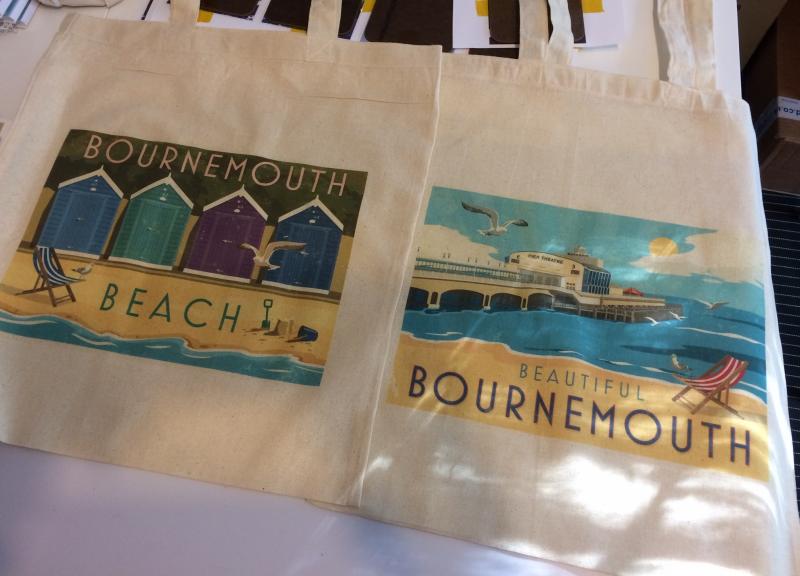

Yes using Jet Pro SS heat transfer paper from Yolo (10% off for Premium Members!). Just about to press a couple of bags so perhaps I will upload a photo later.

I look forward to the picture.
Re: Ricoh OEM Gel ink for heat transfer?
Thanks for prompt.

good result, and if any fading happens it will just look rustic!
