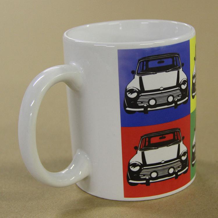

Here's a photo of the whole mug done at 180c for 180 seconds. Base pre-heated for 30 seconds. The base looks great it's the top corner that's rubbish.

It's the same as yours, not sure i like it.......

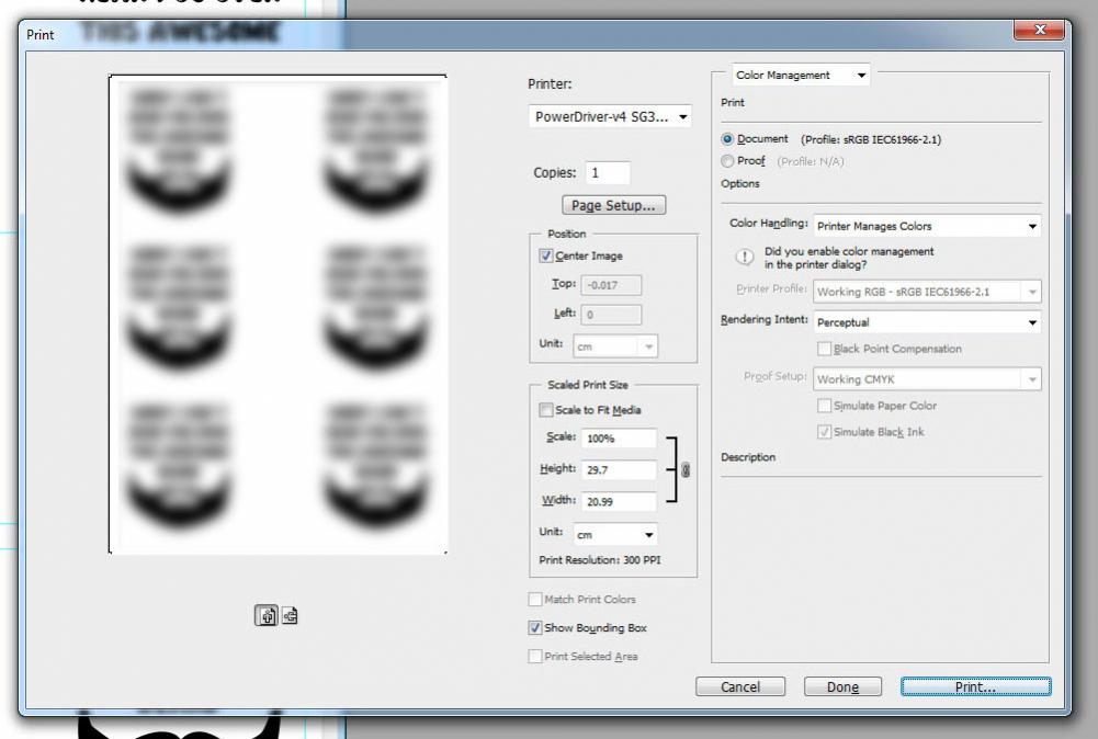

Where do you print from? We print out of Photoshop letting PowerDriver manage the colours. Make sure it's set to "perceptual" rather than "relative".

The only thing now is, how to print more than 1 image per sheet - anyone?
Using PSE13

MCB12;108573 wrote:Thank you! PowerDriver successfully installed and colours looking better.
Using PSE13
Morele
If you look at my image of print settings, it pretty much shows you how to put 3 on an A4 sheet.
